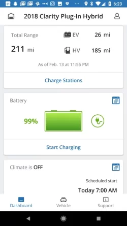

I live in Duluth, Minnesota and in similar and warmer temps, I've never seen more than 28 miles of EV range.
Today, with temps in the low 20s, a 99% charge still showed a 26 mile EV range.

I hop this screenshot is reassuring to @egor.evseev - 26 mile range on a full charge.
