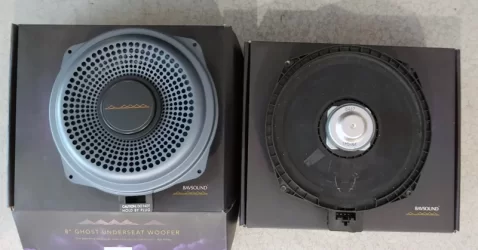

Ghost subwoofers are installed! Will take awhile to do a write up on the installation process but there is a noticeable difference in the mid & bass for the woofers. Maybe it's twice as loud on the mid & bass? Base audio uses 4 ohm woofers (more clarity and louder at half volume) and the HK uses 2 ohm (more punch when really loud).
The Bavsound speakers weigh about 2.81lbs and the stock speakers about 1.08lbs. When I get time I'll do the door and rear speakers!

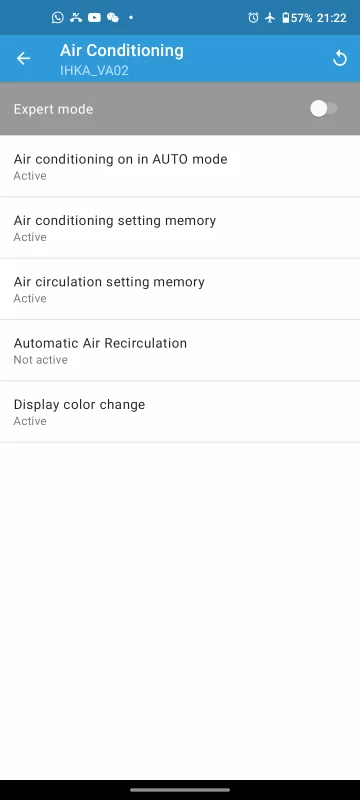

Increased the winter range with bimmercode!
Turned off the auto recirculation 'feature'. It now does what I tell it to do. Should have much more efficient heating in chilly days. It was cold and wet this morning. Usage was in line with a just a cold day.
I just realized, with temps in the low teens the past couple of days, why my windows have been fogging up – even after calling up air conditioning. Time to pull out the enet cable.

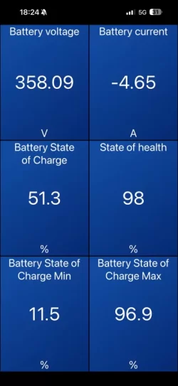

Warming weather caused me to charge my car to 81% last night, in anticipation of driving it today and tomorrow. Cold front arrived early, however, so I chose to deplete the battery on the way home by using the seat heater, cabin heat, multiple maximal 0-35 mph accelerations, and by driving 70 mph via the interstate on the way home. The result? 29 miles covered while using only 22% of the battery, for an estimated total range of 132 miles.

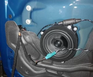

Ripped open the front doors and installed the coaxial speakers for Bavsound Stage One. Audio clarity is excellent and now the treble is much more clear due to the lack of tweeters for non-HK systems.
Very cool.
Did you apply any acoustic damping material ("Dynamat")?
I didn't put any damping material on. The door speakers are already mounted to a plastic housing and I haven't noticed any rattling yet. Next I have to remove the rear passenger seats to get to the rear speakers.

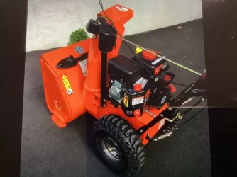

As of Saturday Jan7 it’s been 693 days since the Big Apple picked up at least an inch of snow in a single calendar day and I’m not buying winter tires anymore as I own them for past 20 years on all my cars . SE I drive on summer tires on snow less NY streets . In MN I know you enjoy Hakkapeliittas .About 6 years ago just getting older to help me to clean a snow I purchase that “BABY” I used 6 times and since I change an oil only to keep in shape /dusted is useless equipment in NY .Is brand new ready for sale .Have to add is not EV but electric starter.
