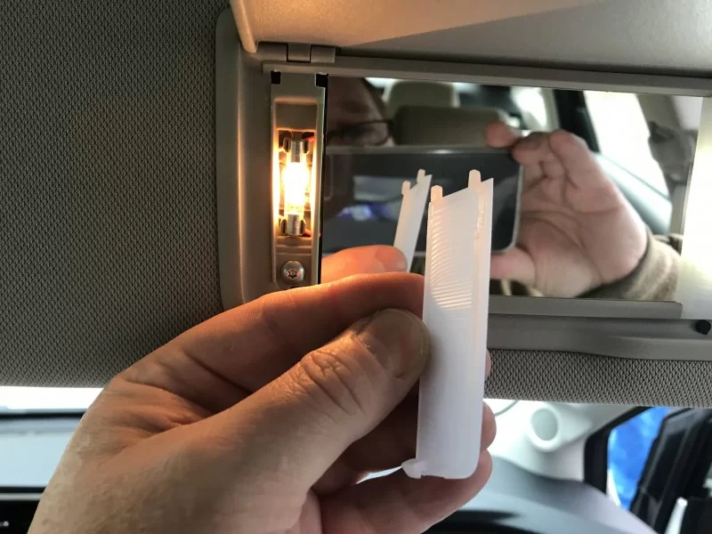

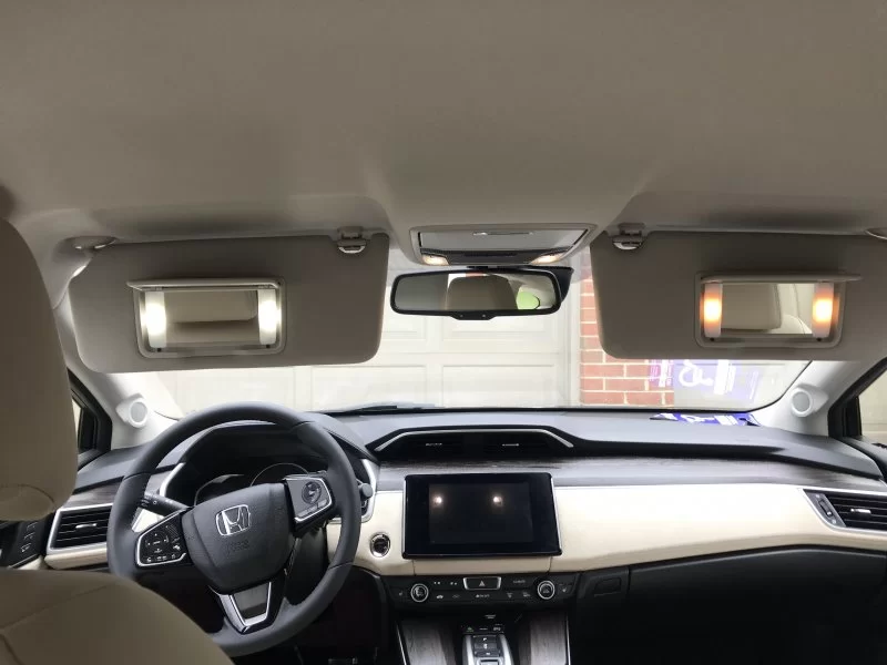

Just received and installed the SuperBright LEDs I posted about. They were the exact size of the OEM filament “fuse” size lights. Went in perfect and took all of 5 min. They are much brighter than the OEMs and I do not find them bluish at all. I’d call them cool white. They are just slightly whiter than our convenience lights which I thought were white but look slightly warmer than these.
One thing to note: these LEDs are polarity specific. Touch them to the contacts before pressing them in place and if they don’t light up just reverse them. Easy peasy lemon squeezy.
Also my original instructions on removal and reinstalling were incorrect. Removal is as stated from prying on cut out on outside top edge but you reinstall by putting the tabs on the top of the cover in first and then you snap in the bottom.
Here are some before and after pix. My apologies for the over exposure and blooming of the light intensity. In real life the OEMs are dim and the LEDs bright. But the colors are representative of how they actually appear. Also included a pix of the opaque cover so you wil know what you’re prying against. I went slow with a dental pik and didn’t break any tabs off.
Bottom line-I don’t think they are blue, just cool white, and so I don’t think the Missus will make you sleep on the sofa if you install these. I’m very happy w them.

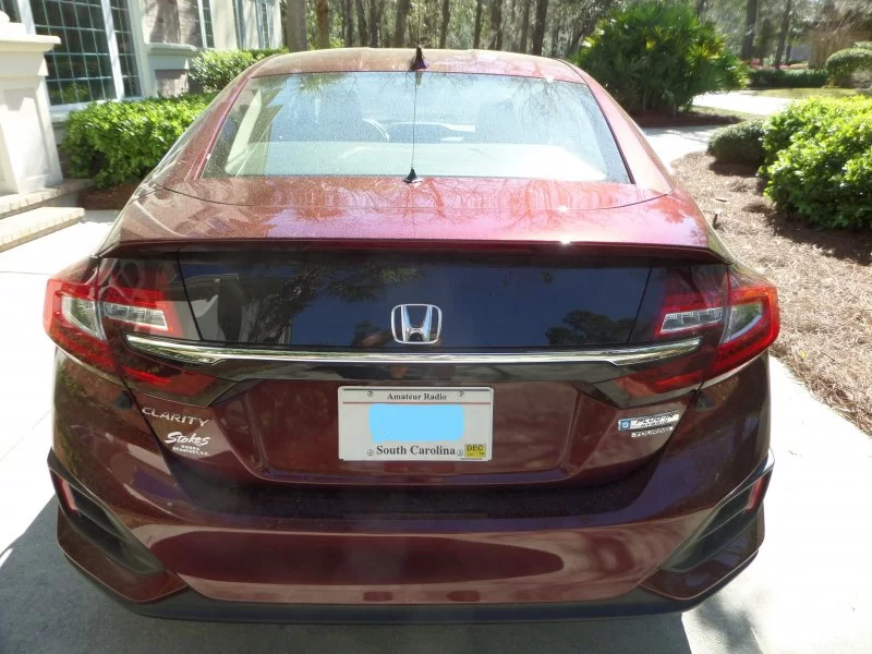

The next picture shows the rear of the car with the two side view cameras and the Ham radio antenna. It uses double sided tape also, since there is not much magnetic around.

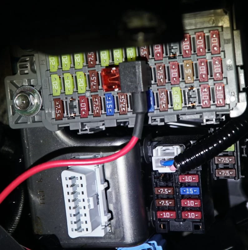

4) There is a fuse box right where the power cable ran. I found a screw for the ground wire and attached it. I then used a fuse Tap Adapter (https://www.amazon.com/gp/product/B00SUTYYS2/ref=oh_aui_search_detailpage?ie=UTF8&psc=1) to install a fuse and supply 12v to the converter which puts out 5V for the dashcam. I used the 7.5A accessory fuse position. There is a nice fuse information label on the left side of the driver's foot well.

nice guide. the only thing I'm not really clear on is what fuses did you put in which slots on the fuse tap adapter and which direction did you insert it back into the fuse box? If you or anyone else could take a picture of the box after install that would be terrific. thanks
I'll post some photos after my wife comes home with the car.
The fuse adapter has two slots. The lower slot is for the fuse that you remove from the fuse box. It will still perform as a fuse for whatever circuitry is attached to that slot in the fusebox. The second slot is where you plug in a new fuse that is appropriate for your dashcam.
After reading other guides I was worried about putting it in the right way because others have said if you put it in “upside down” the device would still work but the circuit breaker wouldn’t work anymore.

The original fuse can be turned around and plugged in with out any ill effects. But the wire going to the dashcam enters the side of the fuse adapter and, if plugged in the wrong way, can bypass the fuse.

great, glad i could help avoid a disaster. I have the A119 camera as well which I'm pretty sure draws only 1 Amp since it works in a USB plug. What size fuse do you use for it?
Not sure what size fuse I used. I'll check when I pull the adapter out to check the direction. I'll have to use my volt meter to determine which connection carries the 12V. There is no indication on the fuse block because regular fuses can be plugged in either way without creating a problem. It's only the adapter that has to be plugged in the correct way. I'm glad this issue came up.
Here's my fusebox.
Here's my fusebox.
I just checked. The middle row, where I plugged my adapter in, has the 12V rail at the top. So it turns out my adapter is in the right direction. When I get a chance I'll have to check my 4Runner too.
It turns out I used a 7.5A fuse.
I threw this diagram together (drawing isn't one of my skills). The fuse on the left is the original fuse. You can turn it around and plug it in reversed and it will still work properly. But the fuse on the right has the wire as part of the adapter, if it is reversed there will be 12V on the dashcam but it will not be fused.
Hope this makes sense.
Thanks a lot, I’ll give it a shot. Any reason in particular that you used that fuse? If I’m looking at your picture correctly that’s #21, labeled ACG, whatever that means.
I'm pretty sure it was the smallest value fuse I had on hand.
Someone said the second fuse shouldn't be larger than the first. That doesn't make sense to me.

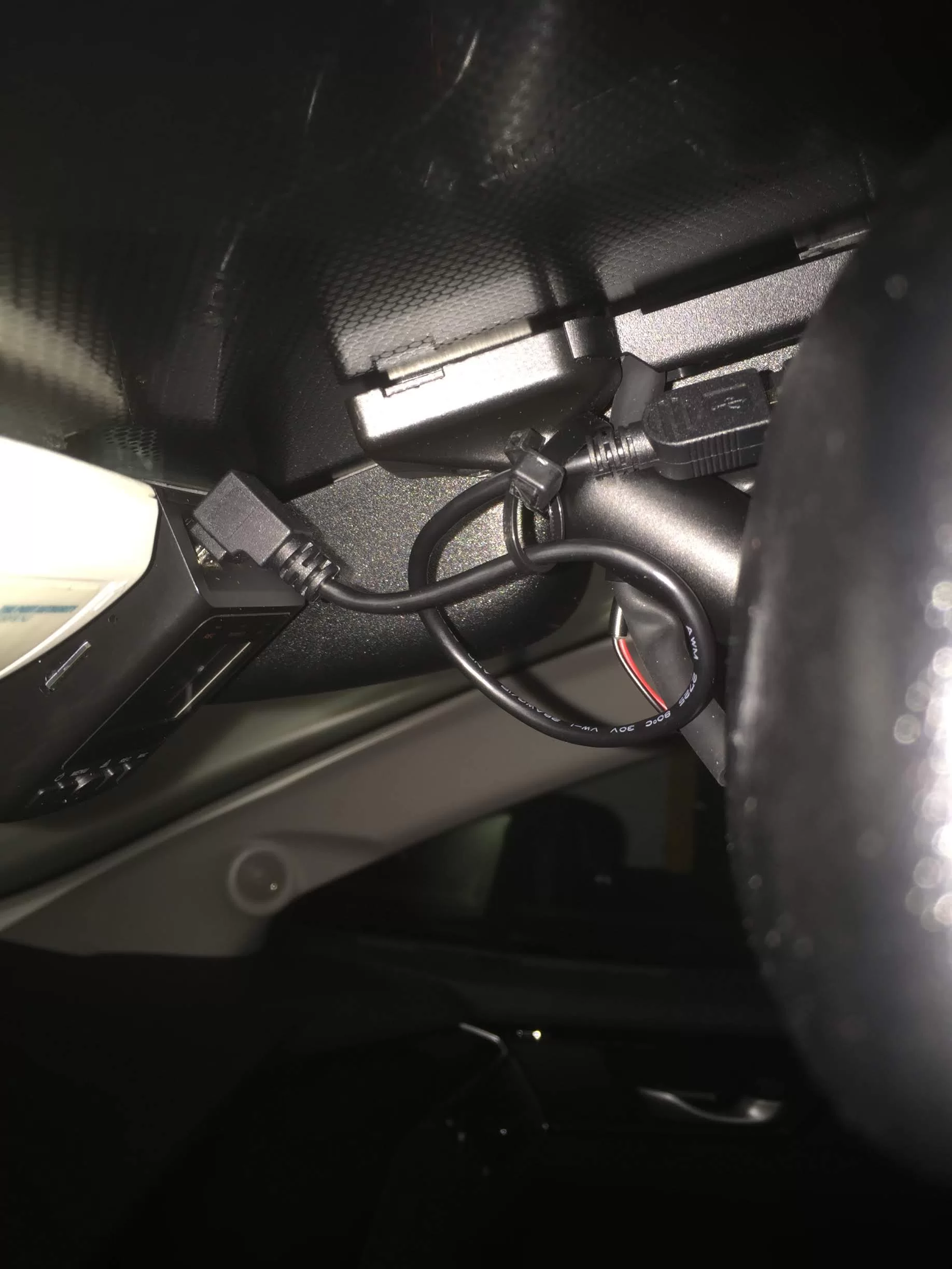

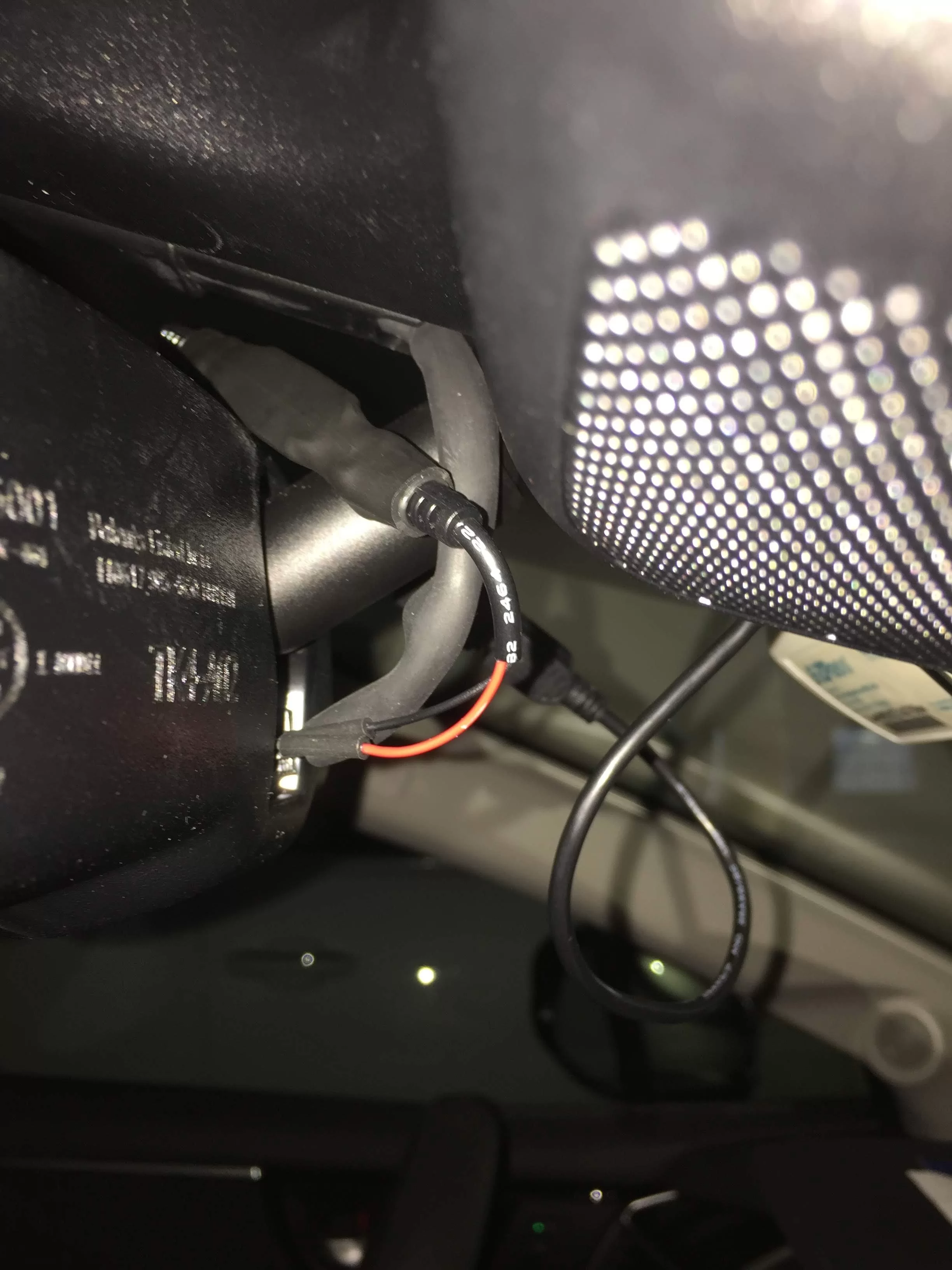

and used this tap (https://www.amazon.com/gp/product/B07BFRWC3X/) to tap the mirror power as a switched source for my A118C dashcam (with some adapters for Micro to Mini USB and longer wire-I've already spoken to the manufacturer about some of this)
(in my prior car, I just sourced an extra mirror harness and built my own power coupling for the dashcam, but I could only find one side of the mirror connector online).
I should have placed the camera outside of my EZ-Pass, so I can see its working in a glance. Now I need to duck under the mirror to verify the flashing light--I'll move it eventually
