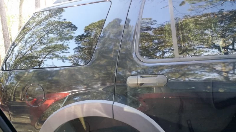

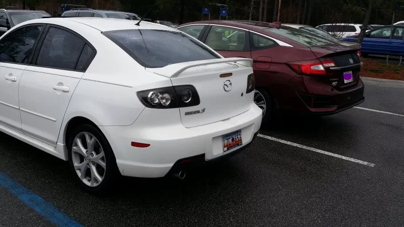

But, as you can see from my comments on the Rear Cross Traffic Alert part of this blog, I decided to add rear side view cameras. The pictures attached Clarity in Kroger Lot.webp show my car in a supermarket parking lot. (This lot has very wide aisles and is on the good end of a spectrum where the local Walmart parking lot is on the bad end.) The camera is the small black dot on the top left rear bumper just to the left of the crack of the trunk lid.

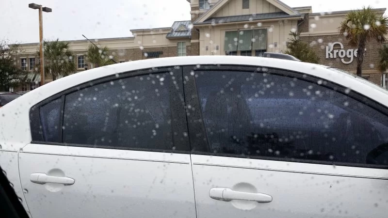

The next picture shows the view of cross traffic from the driver's seat. In these situations, cars driving rapidly down the aisle worry me.

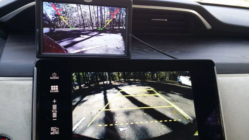

The next picture shows the view of cross traffic from both the Clarity rear-view monitor and my new 5" side view monitor. (The blur is caused by raindrops.) Note the people clearly visible on the side view monitor, walking down the aisle toward me. People are scary but walk slowly. Cars, traveling at 15 MPH, move 22 feet every second.
This was just a quick test on the driver's side, with the monitor tacked in. I have ordered the gear (about $50 from Amazon per side) to do the right side as well. I will also clean up the installation and make it more permanent. I decided to not use the backup lights as a trigger, but have a switch up front instead. Cheers,
I should add that you can also see the people in the Clarity monitor, and they would have been more visible if not for the raindrops.

Nicely done! Do you find the location of the auxiliary monitor blocks the vent to some degree?
The distance from the rear of the 5" monitor to the vents is 3 -3.5 inches. That should be enough to provide diffusion of the air from the vents. I also continue to explore alternate placement options for the cameras and monitors.
One thing is that I often find myself heavily using the large rear view monitor to avoid hitting lawns and sprinklers when I back down a long narrow driveway. When I do this I'm concerned that I focus so much on the rear monitor that I may miss some car coming from either side on the street. Placing the side monitors very close to the rear monitor lets me take it all in without shifting my focus.

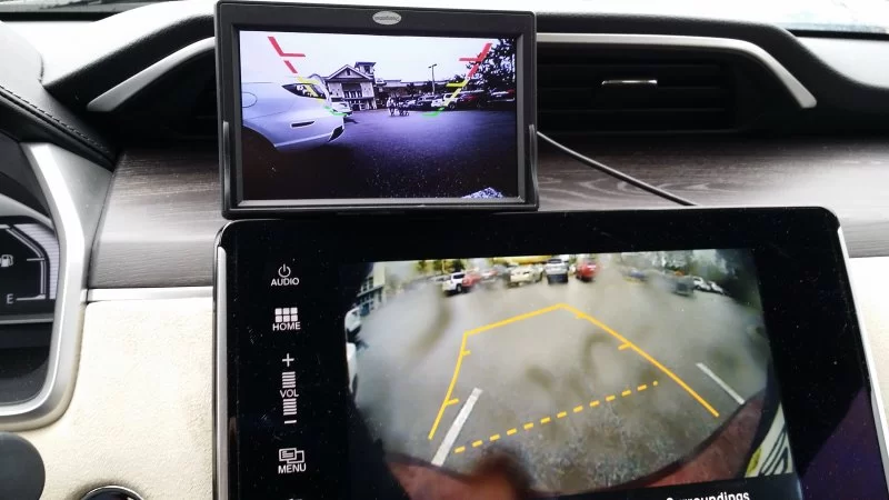

Once I get this thing closer to completion, I will take some better pictures. Meanwhile, here are pictures taken while parked at my dreaded local Walmart.
The first picture shows the rear and side camera views. I feel that the side camera sees further up the aisle and will give me better early warning of a car coming from that direction.
This second picture shows what I see from the driver's seat.
