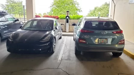

I get about 6.1 kw at the only public free charger in my town. It's one of those Chargepoint chargers (see pic below).. I'm surprised I'm only getting 6.1 kw as I'd think that it's likely a 30 amp station and should get more than that.. That's about what I get at home with my 26 amp ESVEI don't have a level 2 charger at home but I have free chargers at work.
I have no idea what their rating is, I suspect 30A, but in the car I see about 6.3 kW being reported.
if the vehicle reports what is actually flowing in the battery that would be a 30A charger with 90% over-all efficiency.
I get about 6.1 kw at the only public free charger in my town. It's one of those Chargepoint chargers (see pic below).. I'm surprised I'm only getting 6.1 kw as I'd think that it's likely a 30 amp station and should get more than that.. That's about what I get at home with my 26 amp ESVEView attachment 5792 .
Interesting that my 26 amp home ESVE gets the same charging rate.. Not sure why the Chargepoint doesn't allow charging at a higher rate.I was wrong and I see 6.0 kW with the work charger, see my edit above.

I don't know.. I just know that I'm charging at home at the same speed as I get at those Chargepoint public stations. Highest I've ever gotten on a public Level 2 chargepoint station was 6.1 kwh and that's also the highest I've ever gotten at home.so then perhaps the dashboard does not display the real power delivered to battery but the input power of the on board charger
The latter is more than likely correctI don't have a level 2 charger at home but I have free chargers at work.
EDIT: I was wrong, actually I just checked and the charger is a leviton with 32A output and the car shows 6.0 kW on the dashboard at 76% capacity.
I don't know why it's so low. if the charger really outputs 32A I should see more than 6.0 kW.
6.0 kW is less than 80% of the charger capacity at 240V...
unless it's not 240V but 208. at 208V this would be 6.65 kW out of the charger and 6 kW would be 90%.
That's pretty similar to what I have experienced, single phase 240V and the same 3 phase 208VHyundai's docs says 91% for the OBC efficiency.
