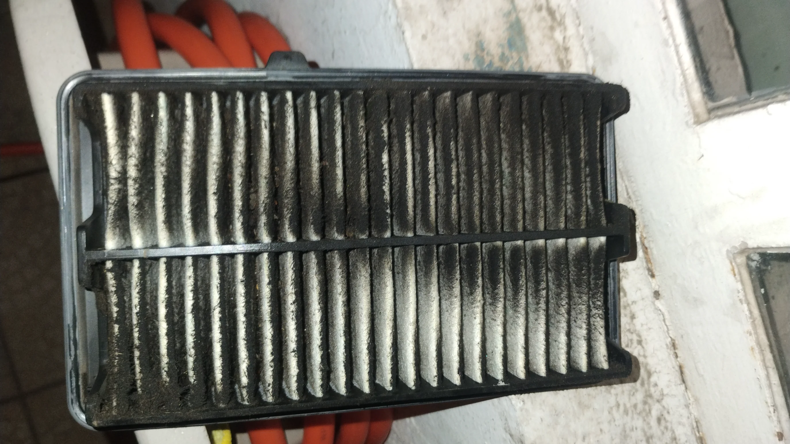

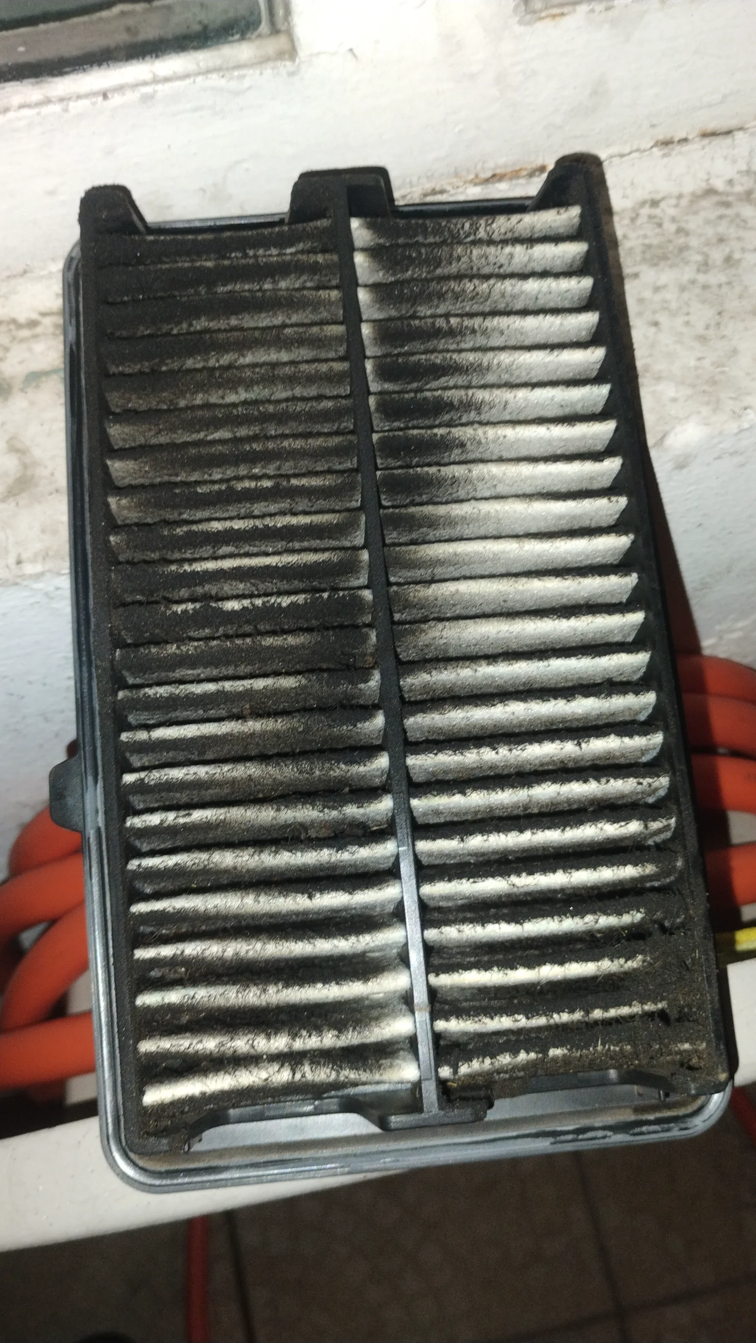

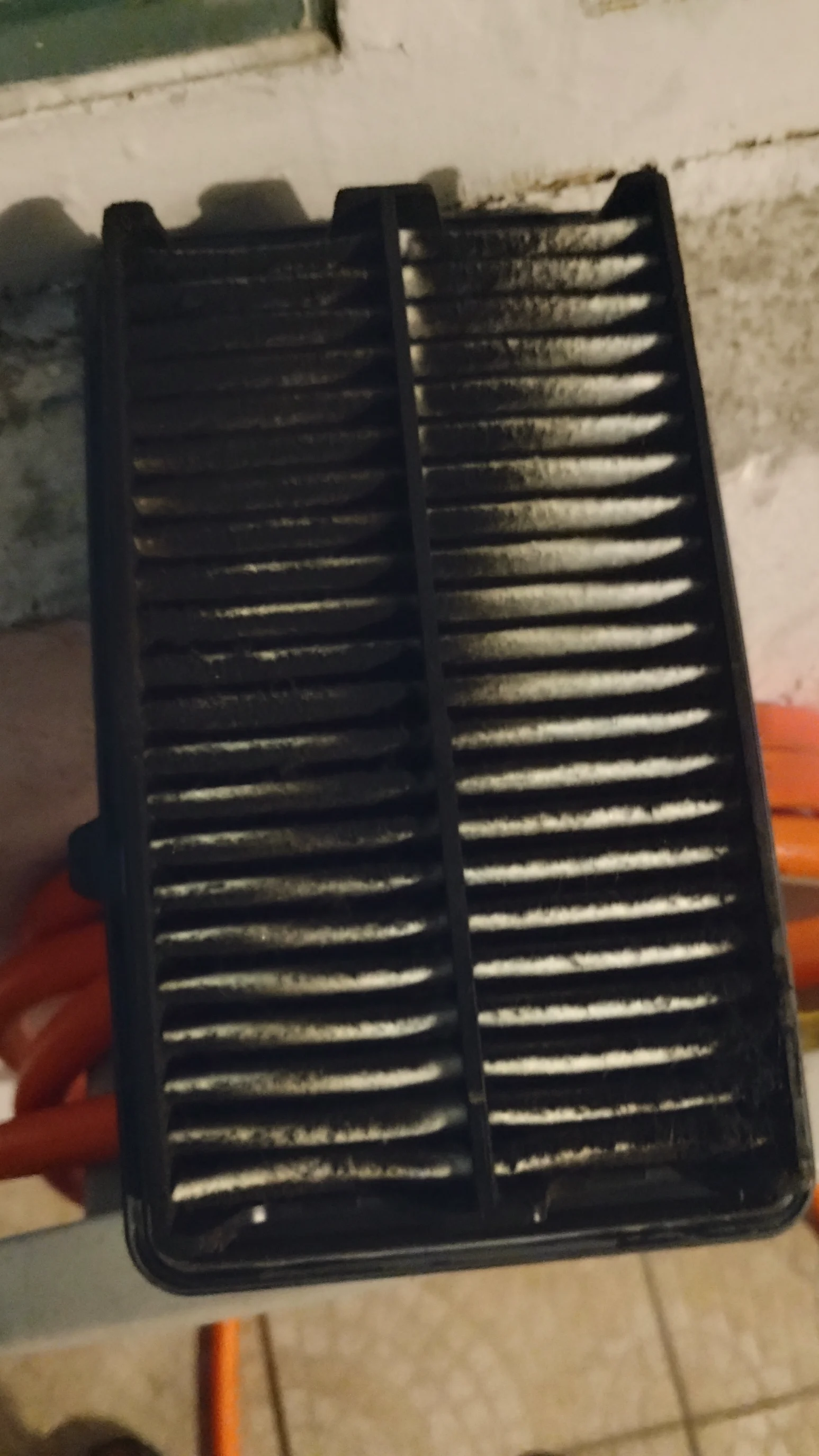

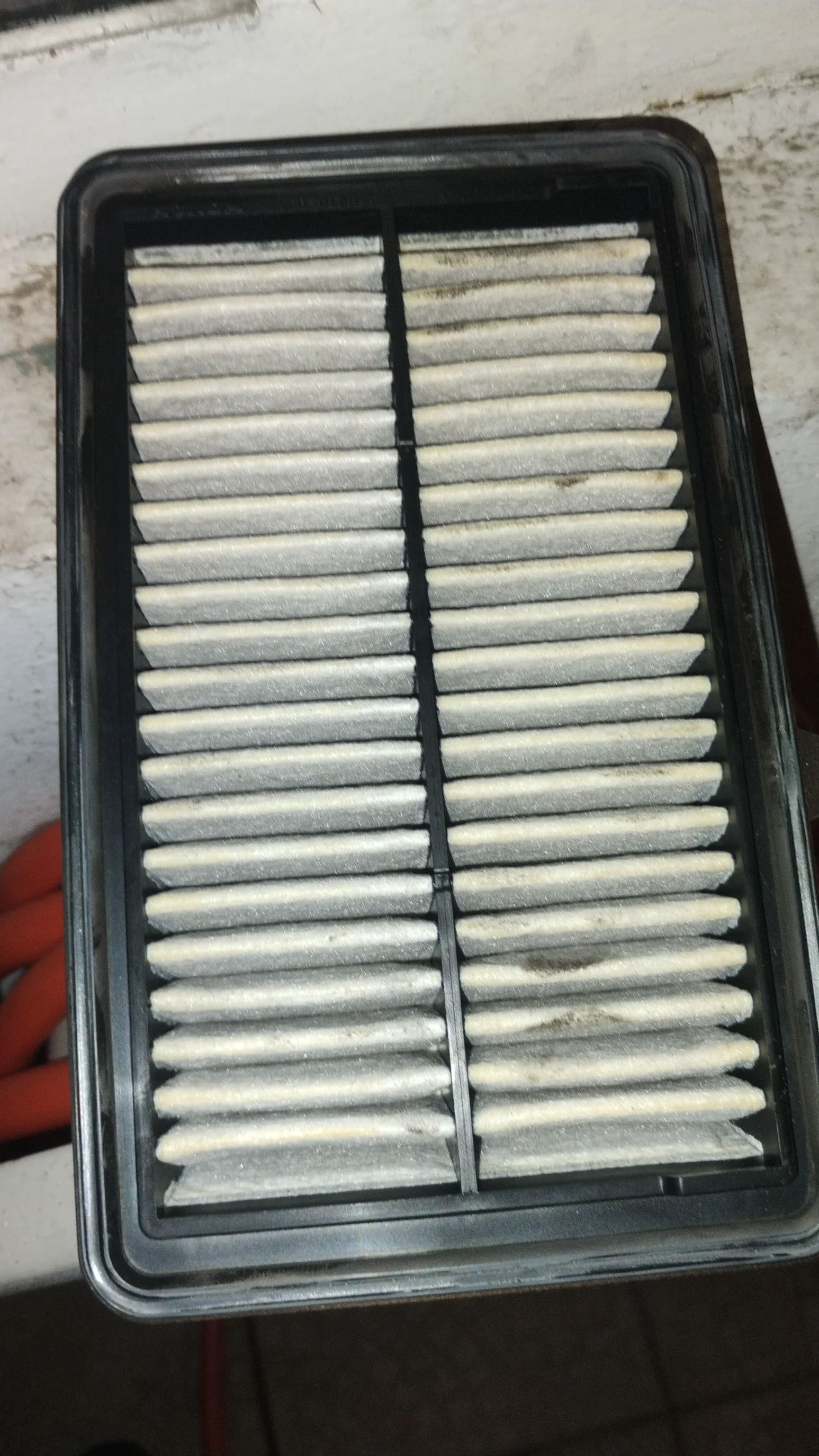

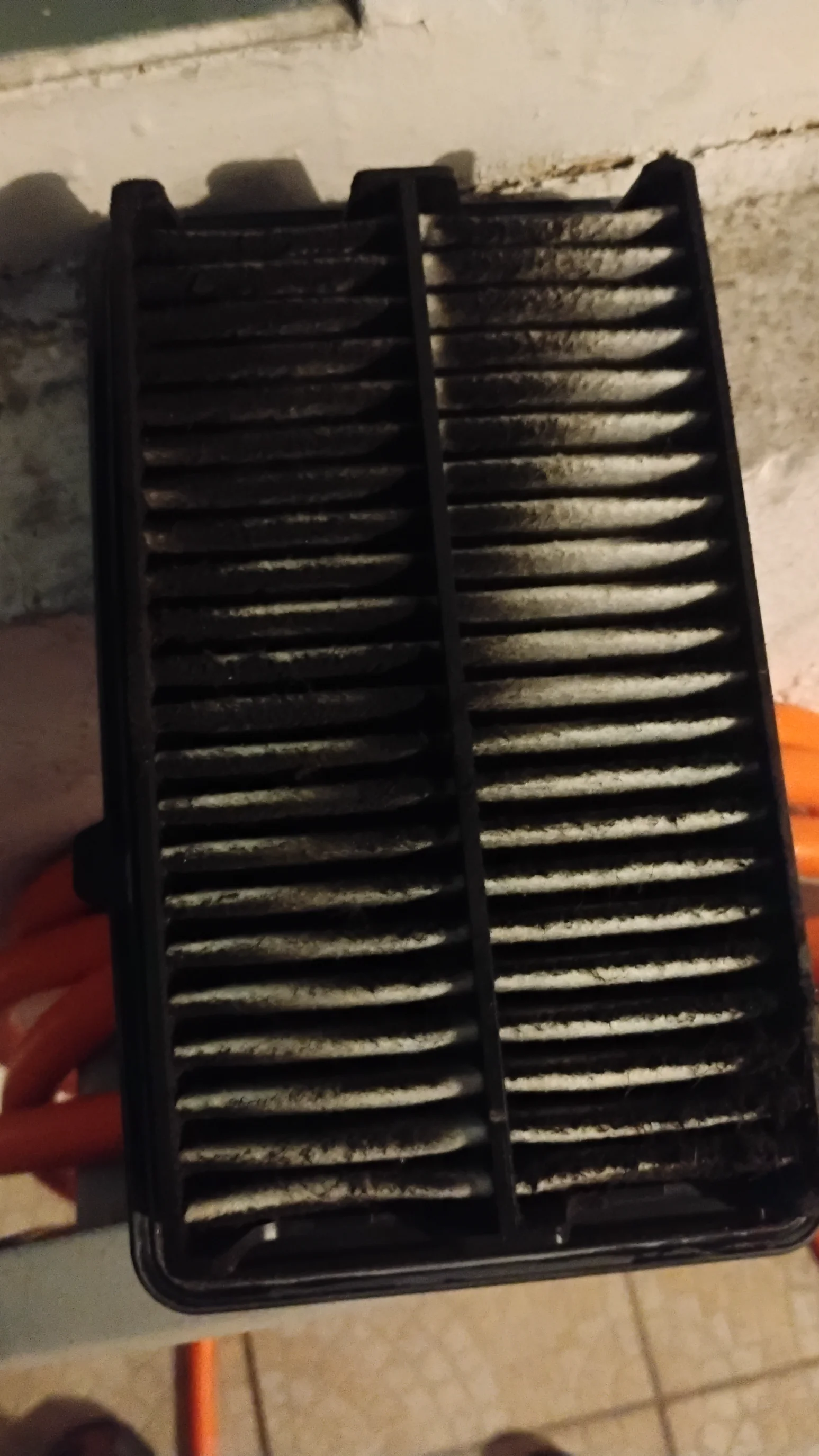

I had completely forgotten to change my engine air filter on my 2018 Clarity until today. It's completely toolless and took about 90 seconds from start to finish. It cost $22 at O'Reilly's.
I'd recommend doing it a lot sooner than I did, or your filter will look like mine- see attached pics

I was involved with power plant air pollution controls my whole work life. An interesting fact for those interested: The dirtier an air filter gets, the better it filters. The dirt acts as additional filter media. But of course it eventually reaches the point where it chokes the flow and that's NFG and its hard to determine where that point is without instrumentation. Some industrial filtration systems use nothing but the dirt on a metal screen as filtering media, with a system to regularly knock the material off and start over.

That is interesting and makes sense. However, mine looked pretty blocked up and in need of a change:). I did my wife's car as well, which was equally as clogged. I always remember the cabin filter, but I have always forgotten the engine air filter.
I would assume that with the top side looking relatively clean, it's doing a decent filtering job. The dirt pattern is also interesting with a diagonal half looking far more clogged.

I'd say it's been 65% ev and 35% gas. I would imagine that air only flows through the filter during gas usage, but I am just assuming. Either way, it was completely clogged with black soot, as shown in the pics. It looks like I was driving through a coal mine for 8 years:)
I'm no expert, but you should probably at least take a look at your filters and decide whether to replace them based on their appearances. They are relatively inexpensive and simple to replace.

Air definitely only flows thru there when the ICE is running.
So, if you have maybe 35k miles on the ICE, that's nothing too crazy. I've seen worse. Good Sanity check just hold the filter up to the sun. If you see plenty of light coming thru, its still ok.

Just looking at your filter, that looks more like an oily substance, not so much dust and grit. You can smack it on the ground a couple times dirt facing down (I do that every time I check my filters) but in your case, I don't think you will get much off.
Just replace it and enjoy another 85k miles.

I definitely swapped out my old one for a brand new one. Mine was beyond any prayer of cleaning it, I believe. IT had been there for probably a decade counting time being built and sitting at the dealer.

My filter REALLY demonstrates how bad the air must have been for us for the year that we lived further south than today. IF you zoom in, you can see the oily black whatever it is in the filter. I had that in my respiratory system. It didnt make me sick, to the best of my knowledge at least, but I could see it in the fluids described above.
