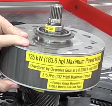

I found a table on Honda's Japanese site that lists the Clarity PHEV with a max 65 kW generator (87 hp).
It is interesting how the sticker shown on the generator during the video that says 106 kW is different than the one at the very end of the video that says 135 kW. :)
