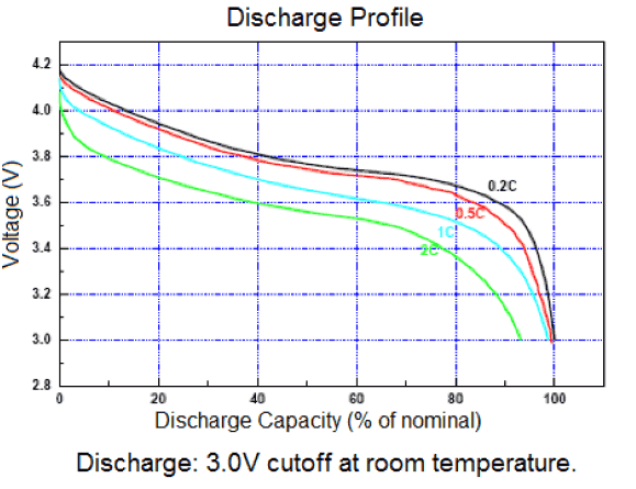

Although multiplying amp-hours by volts looks about right, it's not strictly correct, because lithium-ion battery discharge isn't linear. This image was plucked from a post by DucRider in another thread (https://www.insideevsforum.com/community/index.php?threads/battery-capacity-test-results.5836/page-4). Once the cells get significantly below 3V, you won't draw much current from them (and you'll risk permanent damage).
