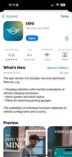

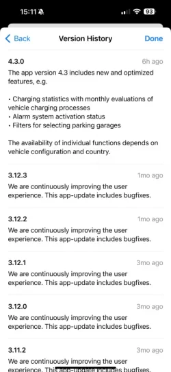

My MINI app took today's major update, and I had last month's minor point update as well. I haven't played with the charging statistics yet, but I did read the eight-page T&C for Connected Services (Canada) — I didn't see a passage saying they'd share driving statistics with outside entities. So what am I looking for in an update?
