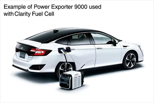

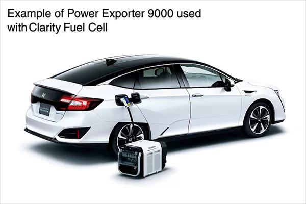

The Clarity Fuel Cell (and the Japanese PHEV with a separate DCFC charging port) can connect to a $9,000 Honda device that provides power from the fuel-cell system or the traction battery.
For the cost of that I'll just get 3 to 4 nice tri-fuel generators that plug into the quick connect I use for my NG weber grill!

I was simply comparing the outrageous cost of that item to the cost of a nice NG generator. I already have a nice gas generator for my needs just curious what was avaliable for the clarity after having a rental jeep 4xe and noticing the power box thing in it.
A generator won’t allow you to use your Clarity as a power source and the Honda 9000 won’t work with your US or Canadian Clarity PHEV.
There’s little value in complaining about the cost of a product that is incompatible with your vehicle. To the best of our collective knowledge, your only option to achieve the stated goal, is to buy a 1500-2000w inverter, which will probably cost even less than a nice tri-fuel generator and be considerably more convenient to transport in the vehicle.
