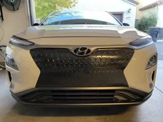

Other than the front license plate which cover 64 of them, no one has posted a mod to cover the other 214 .:D
They do however a good job of hiding front rock chip dings.
This mod also helps protect the radiator from those same rocks, and adds a little improvement cosmetically.

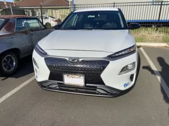

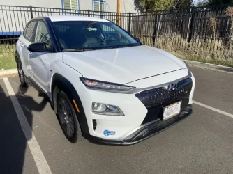

I did it!!!
I got some “7D” carbon fiber gloss vinyl wrap from eBay and some knifeless tape and made my faux grill. I’m pretty pleased with the results. The vinyl was thick and stretchy enough to span over the divots but I ended up having to squeeze the air out from under each one as I smoothed out the wrap, so it took a while.

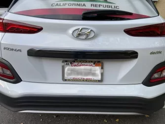

I’m less pleased with the wrap job I did on the rear hatch strip (edges are sloppy) so I might redo that if I have enough leftover vinyl.
In the photos you can also see the white vinyl over the black-painted roof and a bit of my rear-window treatment.
I think that will be my last wrap project for a while.

Looks good! Another advantage being if rocks or debris chip the plastic front the black wrap will help cover that up;)

Wow!! The grille looks excellent. Well done! I cannot see your "imperfections" on the rear hatch. Both sharpen up the look and I think your white roof looks better than the black would have done.

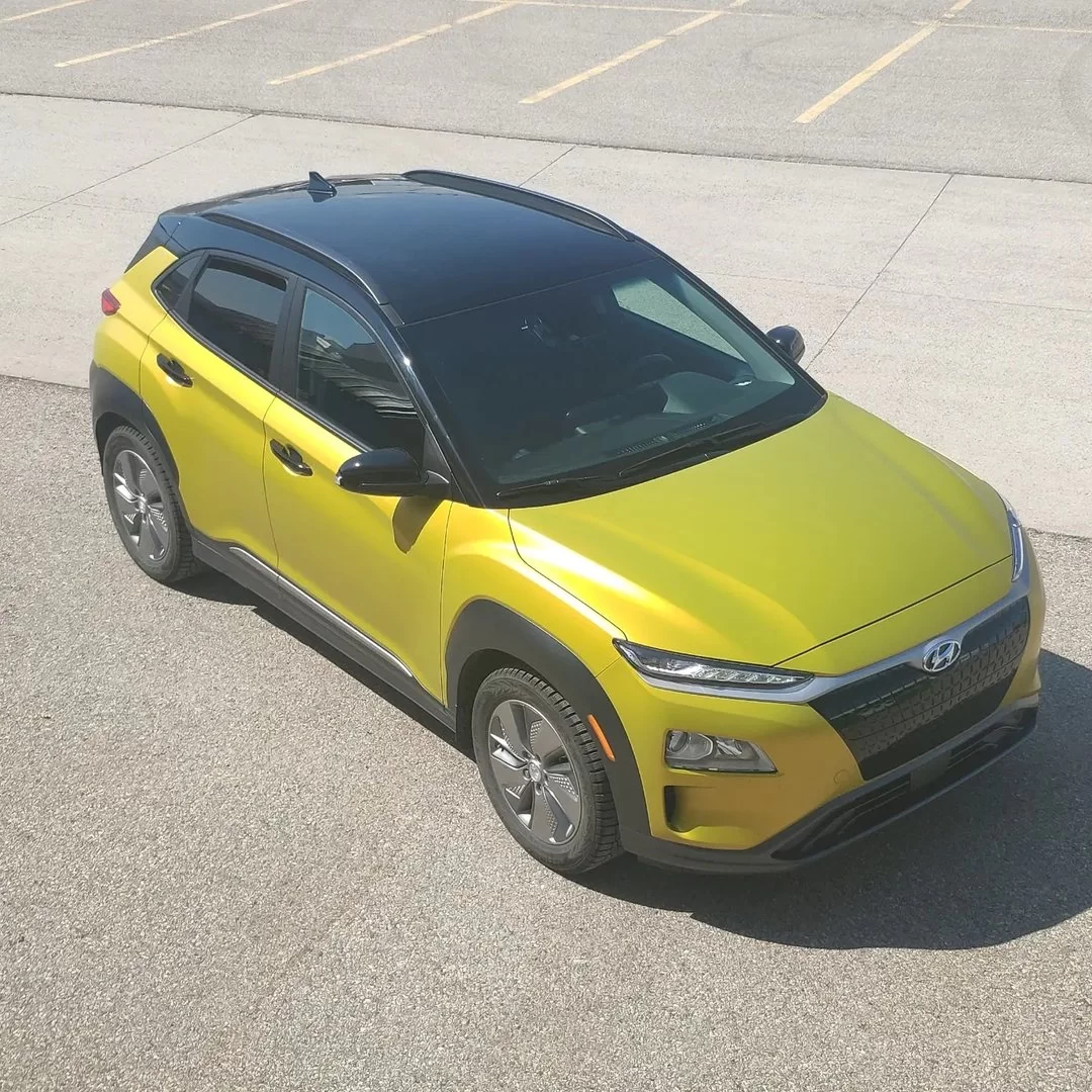

I have the smooth front and had a clear vinyl wrap applied for stone protection.

When I was planning the project I thought I might fill the dimples with clay. I decided against it, mainly to save a (big) step, but also several other reasons. I had doubts about my ability to get a smooth surface that I’d be happy with. I wasn’t confident that the vinyl would adhere to the clay, and was worried that any trapped air would result in bubbles forming under the vinyl. Lastly, I wanted it to be removable so that when I eventually sell the car it won’t harm the value - the vinyl peels off easily without damaging the paint, and I didn’t know if the clay would.
So, I just worked with the dimples. There is still a little air trapped in each, but I pushed enough out to create a vacuum that keeps the vinyl sucked in. The vinyl is quite stretchy and tough, and forms a good seal. If the air heats up and expands a bit, there isn’t a risk of a bubble forming. Not really my original goal, but the dimples are much less noticeable now, and I think it even looks a bit intentional, like the various textured grilles on ICE cars.
