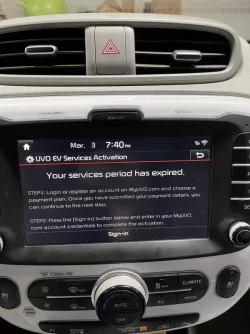

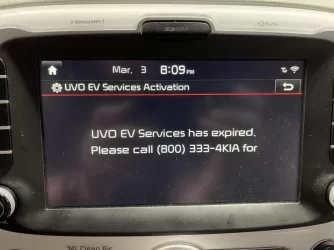

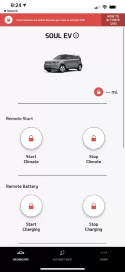

I just received an error in the Kia Access app for my 2016 Kia Soul EV that I need to activate UVO service. I called and they stated since this model uses a 3g modem they "can" (will) not reactivate the service. This results in no way to precondition the car and the key fob does not offer a remote conditioning button, no way to start or stop charge remotely or verify the car is charging remotely, among other things. I’d like to work with you guys to start getting this out there there are some other reports here: https://www.mykiasoulev.com/forum/viewtopic.php?f=6&t=1283&p=11826&hilit=uvo#p11826

“Unfortunately, this is true. For 2015/2016 Soul EVs, customers will only receive 5 years of complimentary UVO services.
The newer models do have a newer modem, but it can’t be retrofitted to the older vehicles.”

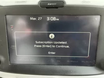

I reached out to Kia yet again because after the subscription expired I’ve been getting a pop-up that will pull me out of Apple CarPlay back to the main screen saying subscription updated, which is just added insult on top of losing connectivity. C013DD0D-35CB-475C-AF1C-D8A96C983120.jpeg
The representative I spoke with on the phone and thought that I should be able to reactivate the service and looked into that for me. As she was having an extended delay getting a hold of the back in support she verified my email and let me know she would get back with me once she had the information. She did send me an email that confirms that they are not able to renew the subscription due to the modem and that the case has been forwarded for the pop up message.
“The info you were previously provided is correct, you are not able to renew your subscription due to the version of your vehicles modem.”
So no solution to the modem debacle I just won’t be able to buy/get service. I am still working with support (2 months later) on the “Subscription Updated.” message they had me upgrade the software (to do this I had to buy a 32gb SD Card with certain specs), however not only did this not fix the issue, it now has introduced an issue where the touchscreen will become unresponsive except for the home button on screen. With the car being on the third EV battery, limited service locations and the recalls/problems on the newer Kia/Hyundai vehicles this will likely be my 4th and last Kia/Hyundai vehicle.

So I was finally able to get a dealer to take a look at the car they stated that the head unit needed to be replaced (for a software issue) and that the district manager had denied the goodwill replacement claim and I would have to pay out-of-pocket to replace the infotainment system which would still not allow service to be turned back on.
