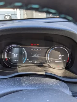

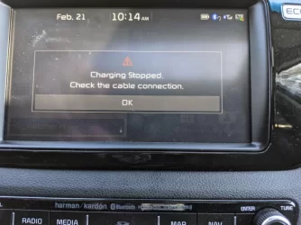

I have a Niro 2019 EV and have been finding sometimes when I connect the charge point cable the car doesn't charge and sometimes it does. Below are the error messages I've gotten, I brought it into the dealership but as it wasn't consistent they just said the classic, well we couldn't reproduce the error. I don't think it is the charge point side as the app accurately tracks when and for how long it is plugged in, also the trick charger that came with the car has the same problem when it is being a problem. I have read about a charging release cable on Niro PHEV but I haven't been able to find the same on the Niro EV. Any ideas? Anybody else having the same problem?
