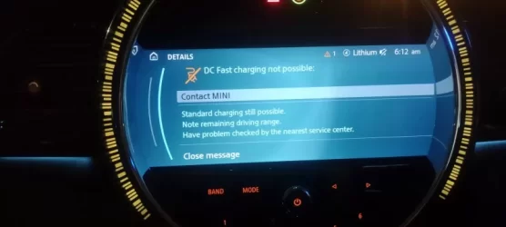

IMG_20230118_061246371.webpMy turn!
This was the last fast charge I needed to get home.
I was plugged in to a Delta evGo charger. Since I hadn't seen a bed in 36 hours, I set climatise and grabbed some zeds in the passenger seat while it charged.
The dash was showing 99% after I woke, about 15 minutes after the charge completed. I unplugged and saw the error when I started the car. Car is charging fine at home. I will try a DC charger maybe tomorrow.
