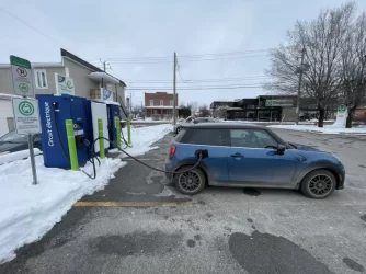

I took a side-on pic yesterday, if you can identify it. I believe you’re correct (Rio Tinto/Alcan). The “holster” has a fairly tight-fitting shroud that should keep snow out.
Yes but the holster is only as good as the last person who puts it back. I've seen some people not even care and then the holster fills up with snow when windy (not covered like the Level 2 FLO ones).
I was looking at the Saint-Eustache one and it was FLO but the Châteauguay one is the dreaded ABB unit. The picture attached should also be ABB...the silent EV killer (at least a few Nissan Leafs in Horseshoe Bay).
