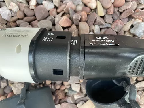

I'd be interested in the experience of others using Type-2 extension leads.
I just bought one for my Hyundai Kona Electric and it's incompatible. The problem is that connector on the extension lead isn't deep enough to allow the Huyndai cable to be inserted fully. See picture. Has anyone else had this problem?
Simon
I would try another cable to see if the problem is the extension or the Hyundai cable.
Either one might be "off", but I'd assume it's the extension.
OK. I've done some more research and I'm going to answer my own question here in case it's of help to others.
Basically, you cannot (or should not) extend an existing charging cable - see legal blurb below. So the only option is to buy another cable of the required length and keep the shorter one as a spare.
