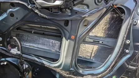

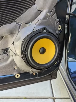

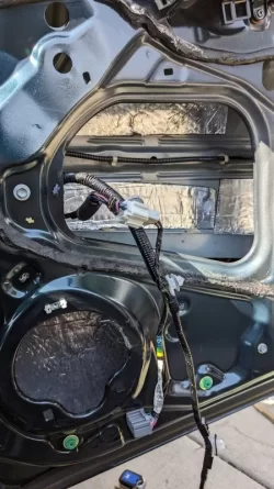

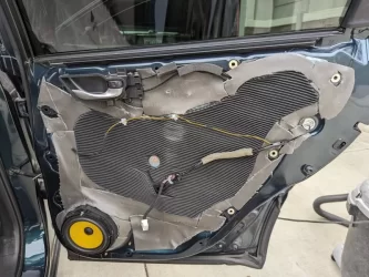

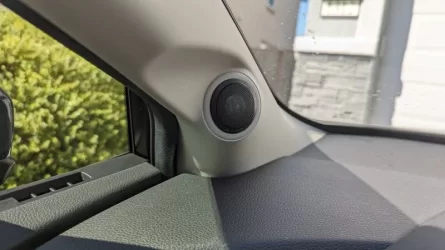

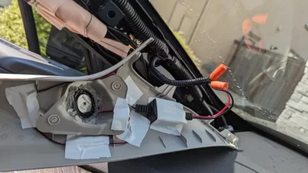

Hey, I did figure it out, pretty straight forward as it comes to wiring. I ended up only doing woofers in the doors and tweeters in front A-pillars (left rear doors As-Is/stock). JLs tweeters are definitely brighter sounding, I didn't want to overbrighten the sound by replacing rear tweeters, so listed then for sale on eBay. Let me know if you want them.
As to the sound improvement, it is definitely better then stock, but I would suggest doing it in conjunction with Flat DSP hack to mentioned on here and few other Honda forum sites. The DSP controls the output of frequencies and putting better speakers does result in incremental improvement but to get ultimate control of sound quality, it's not enough. I tried using the hack without upgrading speakers and it did result in better sound, but I felt the extra bass coming would often be too strong for weak paper-like woofers and was afraid to destroy them. Hence the reason for the upgrade. While at it, I did a proper sound deadening of the doors which I am sure contributed to better mid-bass. Anyways, hope this helps and good luck.
