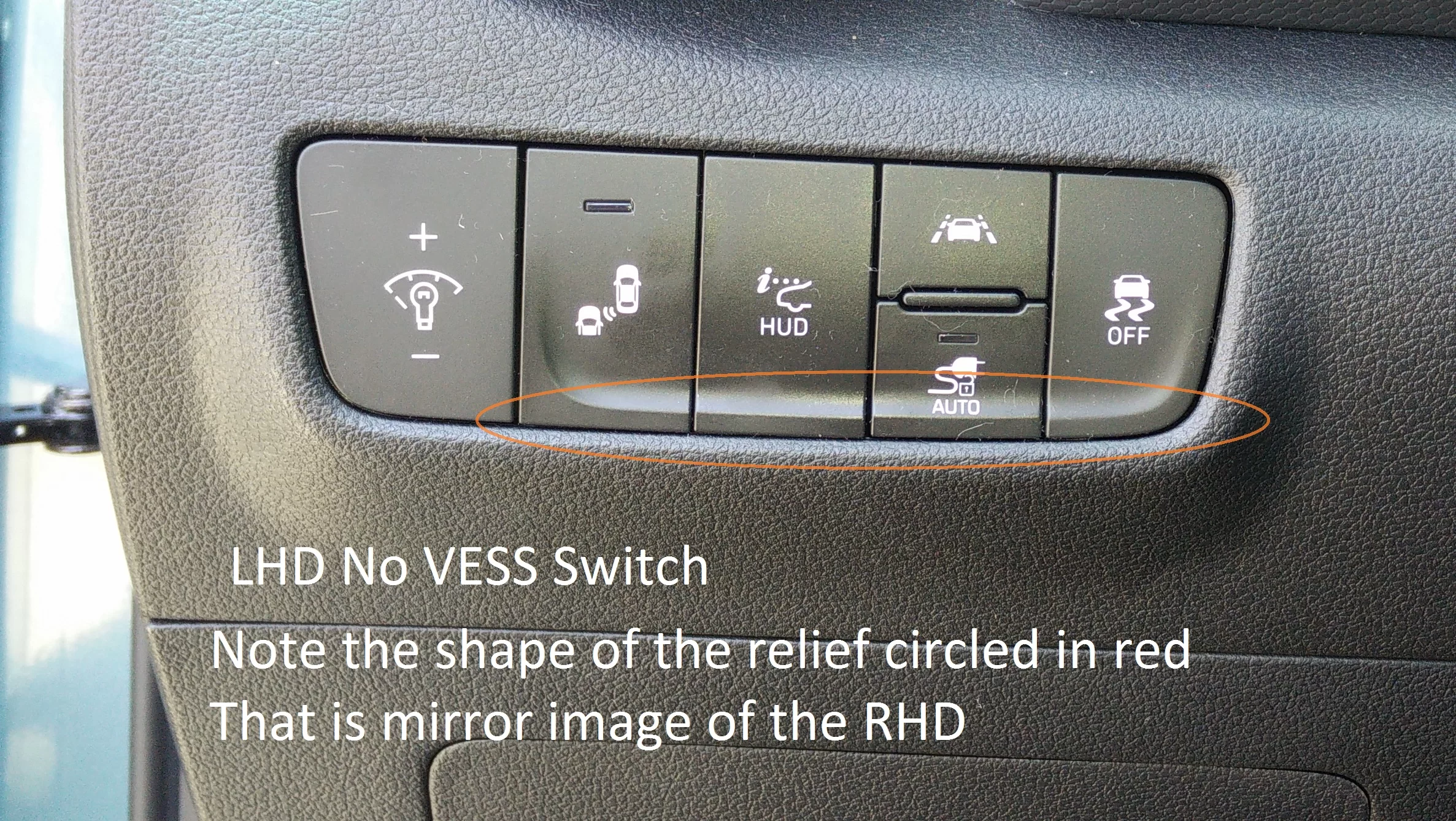

Here's a pic of my LHD without VESS switch. Notice the relief in the controls. The pictures in posts 15 & 20 both appear to be RHD versions. @KiwiME you are RHD, arn't you? So possibly Australia would have a LHD with the VESS switch?
Judging by the pictures the controls are not interchangeable.

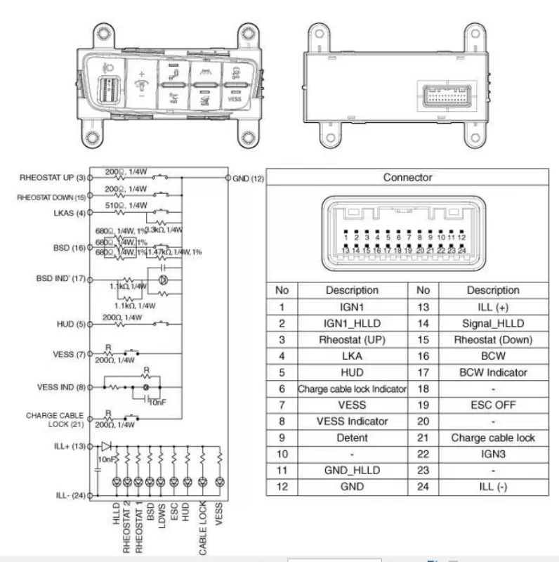

FYI here's the schematic of the button unit from the service manual on the service siteView attachment 5231
Thanks for the detailed diagram.
I would like to know where that green wire that's on pin 7 terminate on the other end, can you supply details of that as it is extremely difficult to access under the dash, Perhaps it winds up in an easier/accessible location? More specifically the location and pin outs of the 2 connectors as shown on this post

I know it is an Ionic diagram but if you have one for Kona connector blocks EM11 and EE11

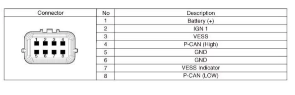

It goes to pin 3 on the VESS module
It goes to pin 3 on the VESS module View attachment 5248
I see it winds up there , just wondering the location of the other 2 connectors on route- EM11 pin 49 and EE11 pin 4, maybe the location of these are easier accessible.
Edit: traced the wiring by hand (best as possible) and from the 8 pin speaker unit (front of car). It seems to join a bundle(s) and to EE11 under the battery side front portion and then joins more bundles to EM11 (I think under the main fuse box in the motor compartment) then carries on to the pad switch in the car separating into its own 20 or so wire bundle. The green wire is there on pin 7 and so is the ground and the pin outs on the 24 pin connector is identical to your diagram.
So no easy access without making some kind of M/F extension harness for the pad switch connector (or pulling off the nose cone).

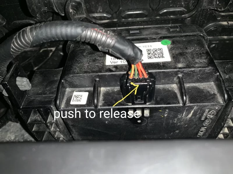

I'm new to this forum.. I just got my new KONA EV 10 days ago.. I was also irritated by the sound.. I was able to easily remove the connector from the VESS unit.
Just push the tab in front of the connector and it will come off easily. No warning messages on the dash and VESS is now permanently off..

Thanks for that, how did you take this picture? mine seems buried in there. If I had that much access I would put the 220 ohm resistor at this point with an in line splice connector
I didn't take the picture.. I took it from another thread on here and added the arrow and instructions how to unplug it. It is exactly that connector.. I have thin hands and long fingers, so I was able to get in there easily. On the US version of the KONA, the VESS unit sits very high, at the same level of the radiator. If you can get your hand in there, you can get the connector off.
