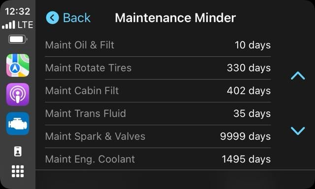

My car is calling for “3” for the first time right now, interestingly enough. I’m at 56,000 and, as mentioned by others, also at 6 years (2019 manufacture).
Also, note that if you have an OBDII reader, you can get the days until due for all of the Maintenance Minder items. (So you could use this to check when your car is planning to call for it. )
I imagine the car also uses mileage to decide(?), but in any event days until due is all you can see via OBD. Attaching a screen capture as an example (CarScanmer app using its Apple CarPlay interface.)
It uses mileage and days. The anticipated service is displayed in days and the calculation is based on past and expected driving habits. A simple test to demonstrate that would be to let your car sit for 10 days, and the oil and filter would still be due in 10 days, after 10 days had elapsed. Conversely, if you drove 500 miles today rather than 50, the oil and filter might be due tomorrow.
This kind of testing would be up my alley. (I like to know how things work just for interest.) But, alas, while your underlying logic is not unreasonable, this is an impractical test for my car because my one-year date is, in fact, in 10 days. So, unless I drive several thousand HV miles before 7/21/25 (which I am not), that days-until-due for the oil ain't going to change. :)
Sometime in the future, though, I'll test it with the tire rotation item by noting the days-until-due prior to a road trip, and then see how the days change as I put some rapid, significant miles on.
Not only is it “not unreasonable” I’ve seen it with my very own eyes. A01 service due in 3 weeks, left the car to sit for 5 weeks, 5 weeks later, A01 service due in 3 weeks.
Yes, the days until tire rotation, as well as days until oil/filter change, will be modified after you drive significantly more than is typical. Your oil/filter is going to reset to 365 days. Imagine if you drove 5000 miles in the first 65 days after the oil change, do you believe the MM would indicate 300 days until the next oil change is due?
Oh, I harbor no beliefs about this. My expectation is that the Maintenance Minder must take into account mileage in some manner to represent Honda's defined maintenance schedule; there would be warranty liability implications if it were not that way. My reference for "not unreasonable" was to the proposed test method (i.e., drive more or rest the car to see the MM item due date change one way or the other). This would be a simple test generally but is impractical for the oil item I have coming due shortly. [The year is up in a few days, and so nothing I do can extend the days due, and going the other way, I'd have to drive roughly double the number of HV miles I've driven in the entire past year to see the due date move up before that calendar requirement hits.]
