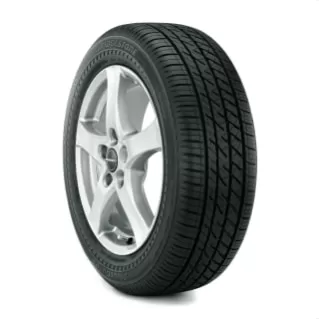

Here's a RFT from Bridgestone - size is OEM - similar to the ones on my BMW 528i which I love:
DRIVE GUARD
Touring All Season
Size
235/45RF18
Price $ 254 99
The alternative size 245/40-18 is a better choice as the tire is slightly wider and still maintains the same OD.

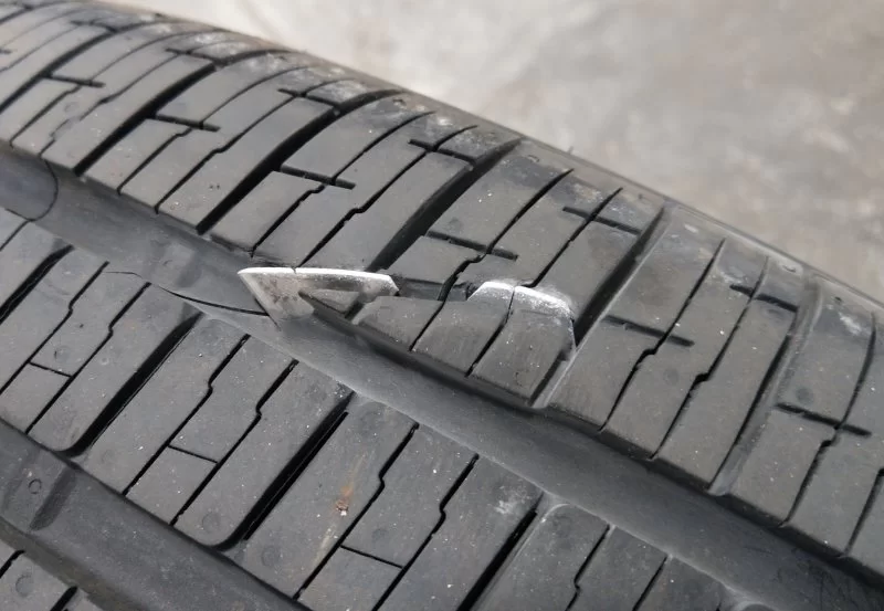

As my luck would have it I picked up a huge chunk of metal in one of my newly installed Pirelli P7 tires. Needless to say it is destroyed. I installed my HR-V rims with snow tires for now until I can get a replacement tire. It is almost winter time here in RI but the snow tires are so noisy, especially at low speeds, I would rather wait to have them on until the end of December if possible.
Regardless I can say that the Pirelli P7's are an awesome upgrade to the stock Claritiy tires. YMMV but I am extremely impressed with them on my car. That was until I unfortunately ran over a chunk of metal ruining one of them.
