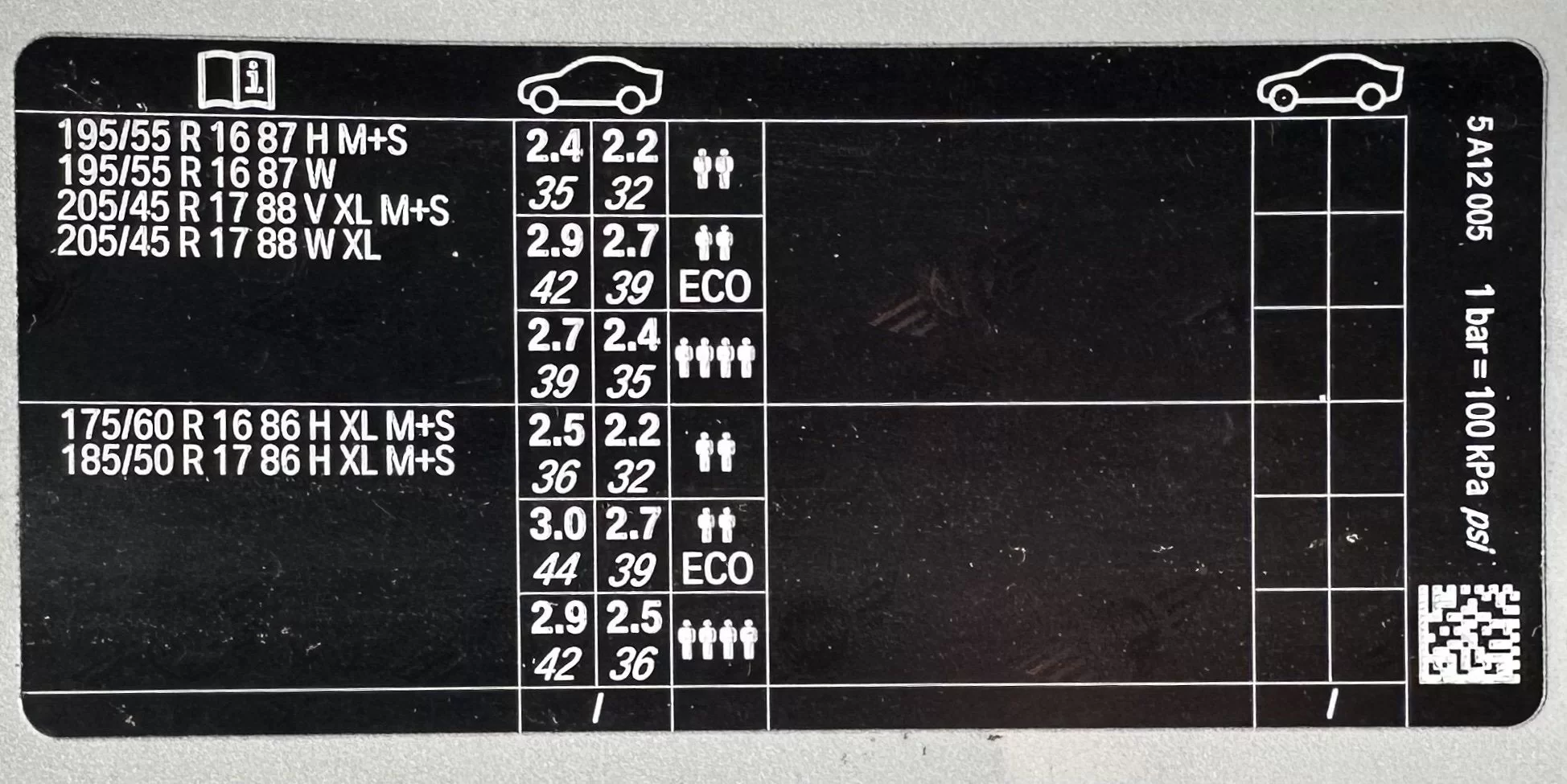

The UK spec SE gets a more informative tire pressure label than the US spec.
If I'm reading that chart right, if I go up to 42/39 psi from the 35-38 psi I'm currently using I should get even more range ("ECO")?
