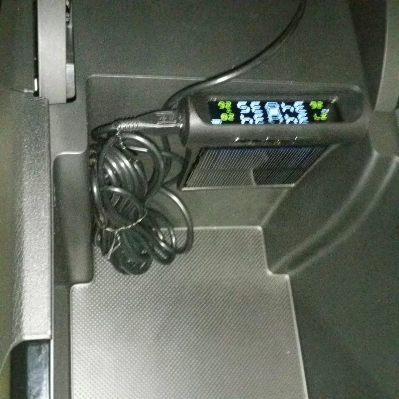

I bought the Vesafe and it seems to be quite accurate and reliable.
https://www.amazon.ca/Universal-Wir...&qid=1546017203&sr=8-19&keywords=tpms+systems
I might get one of those but instead of trying to figure out where to mount the display unit in the car I'm thinking about keeping it in the garage mounted somewhere easy enough to glance at when I walk out to the car, assuming the range is adequate enough. Or maybe it's not good to power the display unit 24/7 so I could easily rig up a power switch for it since it seems to be USB powered. Is that better than having tire pressure in front of you at all times while driving? No, but it's a lot better than having to go around to each tire with a tire gauge which I currently do, but not nearly often enough. But if I had a nice little electronic thingy in the garage that will give me a near instantaneous tire pressure readings I would probably look at it almost every day. I would though bring it with me on long trips.
I have one. It comes with a non skid pad and I keep it on the wood just above the center display. Optionally you could keep it in the console. The unit works well,

I put mine at the back of the center console. Mounted vertically with two-sided tape it leaves space to the side for the long cable it came with. It's plugged into the lighter socket at the back of the console. Sorry about the blur.
