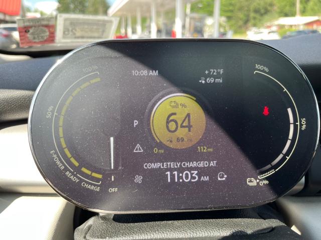

I was doing some traveling this weekend (about 325 miles) and had to DC charge along the way. For those who have traveled with an EV, you know that typically you only want to charge to 80% and then move on. That last 20% can take as long as the first 80%!
The car reports time to 80% in the dash. But I know it tells the charger time to 80%. Some chargers display it on the screen, others do not. But the car knows. I wish it would display it on the dash - or at least the app!
I’ve asked around on FB, so I think the answer is no. But. Is it possible to have the car report time to 80% instead of time to 100%?
Estimate 2.5% per minute (0-80% SoC) if you are getting optimal DC fast charging.
So it would be 80% by around 10:15AM or later.

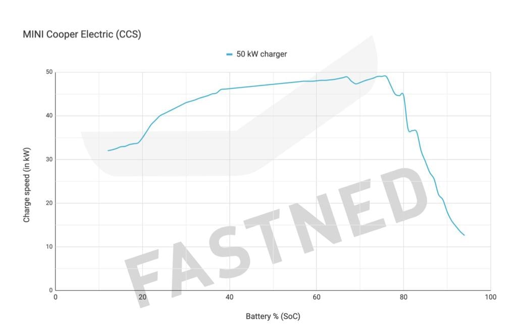

I have only used DC charging a few times when I first had the MINI (free). I found the sweet spot was actually 90%. It is only marginally slower than the under 80 rate. To 95 starts to slow, but only adds 5 mins. From 95 onwards crawl, with the last percent seeming to take an age.
From the data, the real sweet spot is actually just under 80%. 80-90% sees a sharp drop in charge rate. When making multiple consecutive charging stops, that extra few minutes starts to add up.
Sure, but it’s such a small battery that the difference between charging at 49.6 kW and 36 (or even 25) is almost insignificant. I've let mine go to 96% at an EA (after using a nearby free Chargepoint 6.6 kW while having lunch to get from 20 to 40%), and it added maybe 8 minutes over stopping at 80.
The flip side is that the MINI’s peak is much fatter than on some cars that boast super-fast charging, but only ride the peak between say 40-50% and then roll off.
