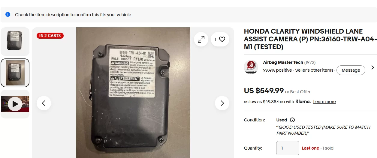

My windshield camera died a couple of years ago and it was a bear to find a used replacement part. WIth a used part, you can pop it in, and drive as normal. With a new camera, which will cost you around $1,100, you will need to calibrate it at the dealer or a windshield replacement company. The dealer will charge you $2500-$3500 for the part and calibration. Used cameras go for $450-$750. Part number is 36160-TRW-A04.
You might be thinking that you will just bite the bullet and buy a used one if your's goes bad. Well, good luck with that. It took me months and months of scouring ebay and online junkyards to find a single one that cost me $750. There just so happens to be one on ebay right now for $550; but as soon as that one is gone, it may be extremely difficult to find another one.
Example of a used Clarity windshield camera on ebay- SEE screenshot below:

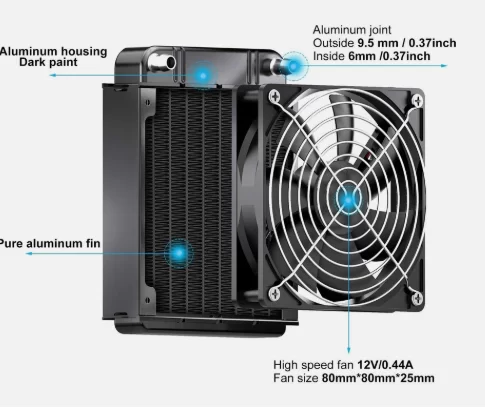

The water is kept cool via a radiator and a 12v fan. (I used a smaller version of this picture, but this gives one the generally idea, as it looks very similiar to the one that I used, just with a 60mm fan and a proportionally smaller radiator.)
And I used tubing to run the water from the water pump located to the upper left of the foot brake to the windshield camera routed under the headliner and corners to connect the 2 locales.

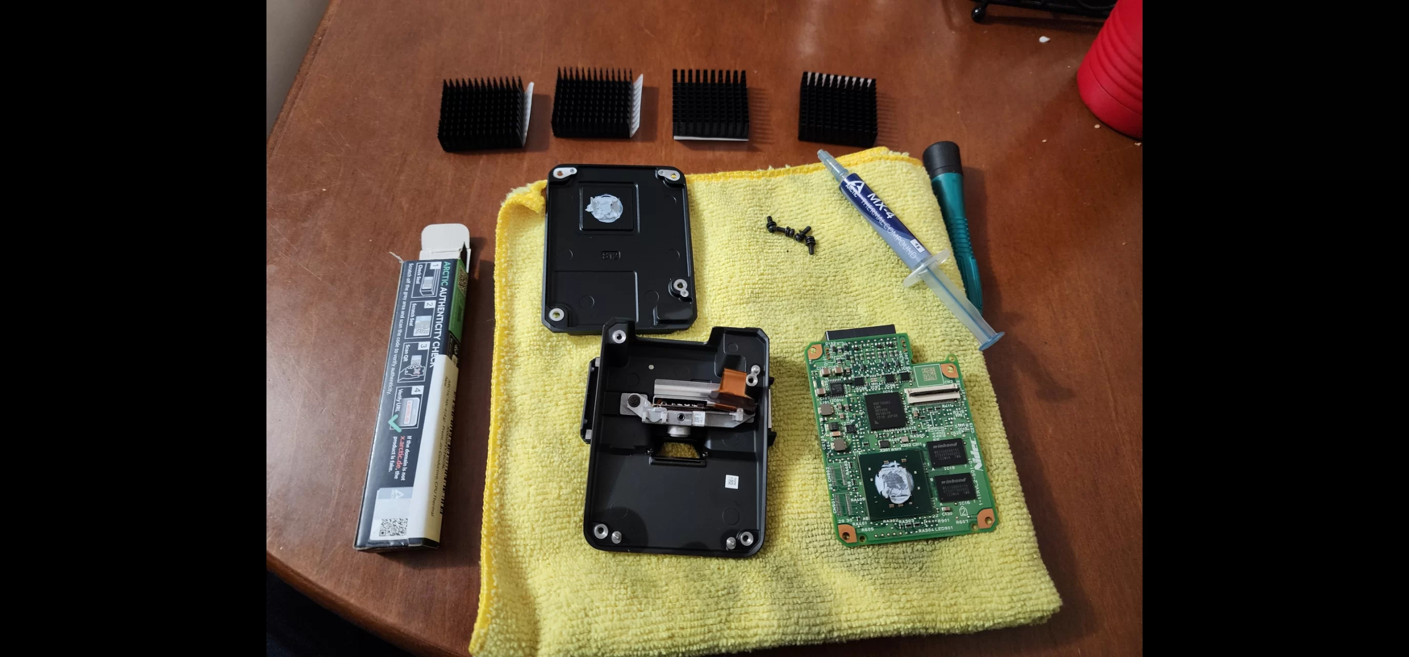

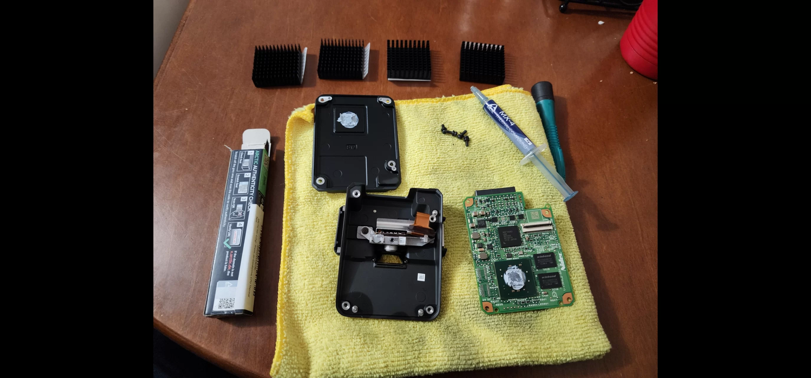

I will follow up in the future on the heatsink that I recommend mounting to the camera enclosure. One method is just using a heatsink. The other is using a different heatsink with a very small fan mounted to it. The fan can also be powered via very small wires routed to the ODBII connector near the foot brake that I mentioned earlier.
I will also go into how one can disassemble the camera housing to remove the existing thermal interface material (TIM); and how to purchase and apply a better, higher quality TIM to the camera chip/camera enclosure contact area. When I opened my bad camera, the TIM was all dry and crusty, which is the exact opposite of what you want in your TIM. Cheap TIM's dry out over time especially in hot environments, which is what happens in many Clarities. Once they dry out, the camera chip temp can soar, as it is no longer properly thermally mounted to the enclosure, which acts as a so-so heatsink in this application. The heatsink or the heatink/fan upgrade, along with a new TIM and the reflective tape, should keep these windshield camera microchips cool enough to last many more years.

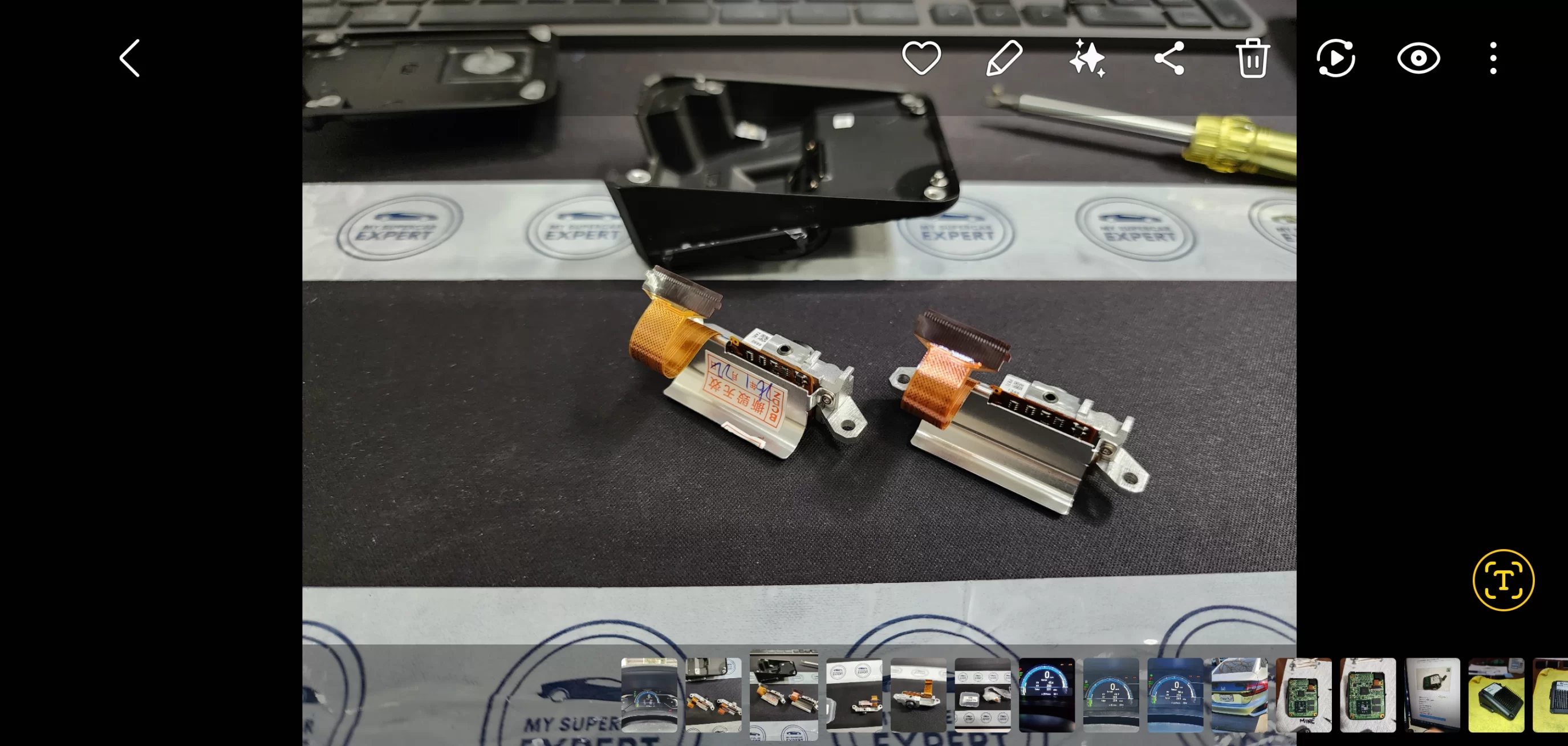

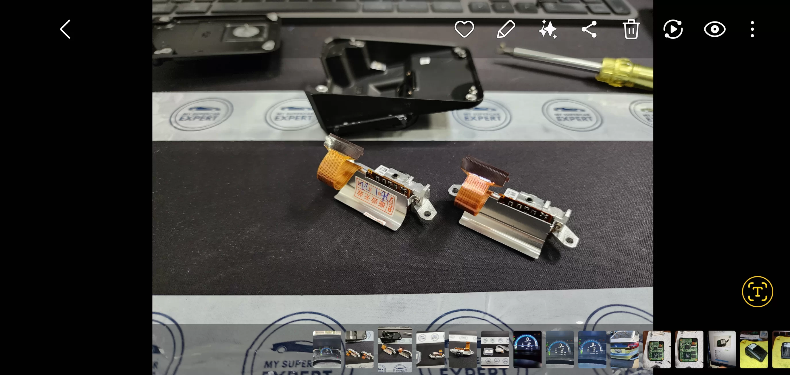

A guy who will accept a broken windshield camera and repair it for $350 with no calibration needed afterwards; with a month or 2 warranty contacted me about his services. I dont know the guy from Adam, so you would need to do your own due diligence; but I can pass along his contact info to anyone who private messages me for it. Once again, I know absolutely nothing about this guy; but he seemed knowledgable on our emails back and forth. I can not vouche for him in any way.

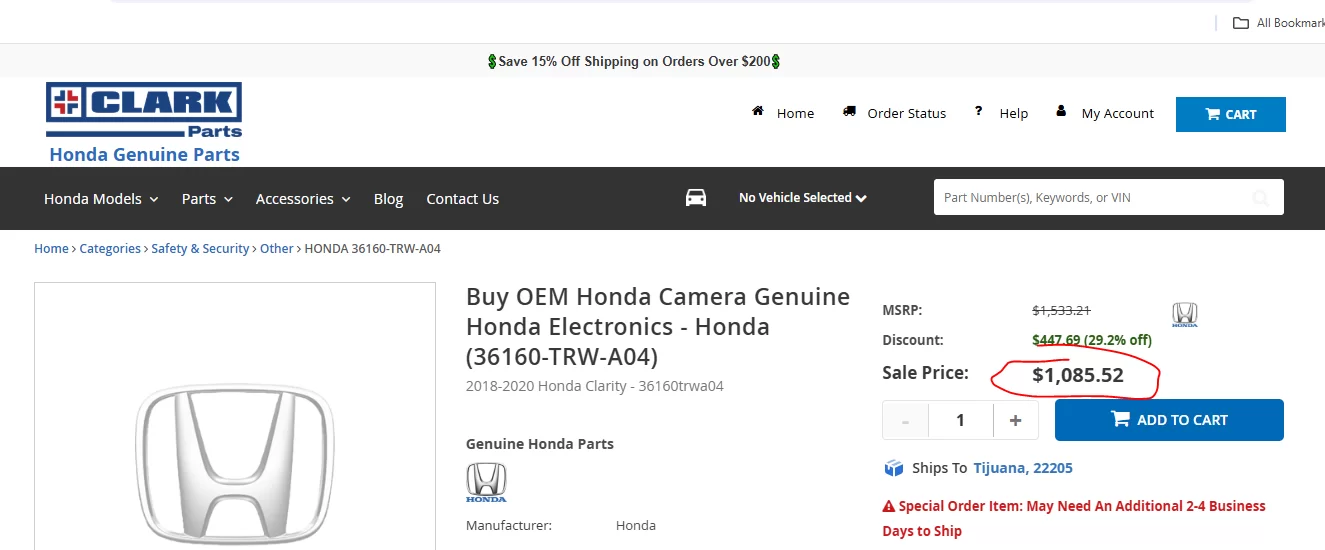

Please send the $160 link. Are you sure that you are talking about this, as there are multiple different cameras in the Clarity:
Below is a common price for a new windshield camera- remember that a new one will require calibrating from either a dealer or a windshield replacement place, if they have the equipment to do it. You can't calibrate yourself to the best of my knowledge.

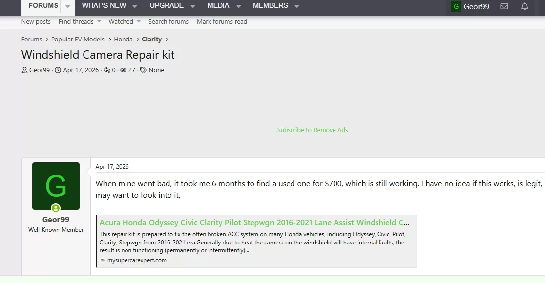

It may have been me who posted that link in the forum:). I saw the link, posted it, and said that I have no clue if it works or not- see below:)
Not as good as the $160, but here is someone who repairs them for $300.... Looks like you mail yours in, it is repaired and returned...
Edited to add: This seems to be the same guy as @Geor99 mentioned. He advertises for $350 on Ebay, although he seems to offer lifetime warranty...
