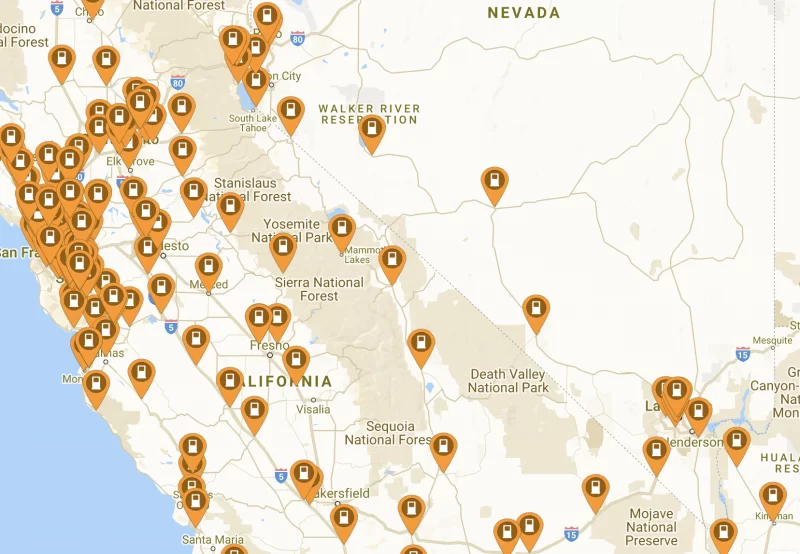

Tons! Look at PlugShare.com (or their app) and you can get an idea (adjust it for your charging needs i.e. Tesla vs. CCS) This is a rough idea of the number of Tesla (green) and Tesla Superchargers (yellow) in that area -- "rough idea" because as you zoom the map on the website, more may appear.

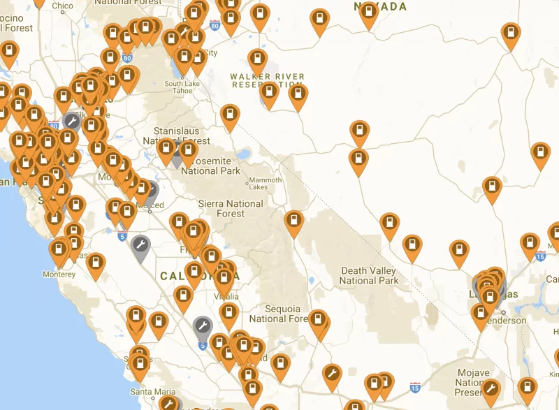

There are thousands of charging stations between Las Vegas and Sacramento. However, keep in mind that, on the road, speed matters. You only want the fast charging stations and there are basically 3 flavors of them :
Tesla fast chargers Sac to LV
CCS fast chargers Sac to LV

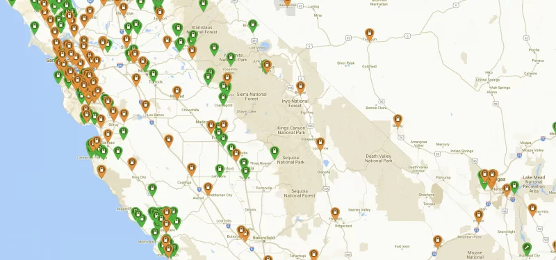

Tesla has deployed thousands of fast charging stations they call "Superchargers" that only work with Tesla cars. The other 2 flavors are a Japanese standard called "CHAdeMo" which only Teslas and some early Japanese and Korean EVs can use, and CCS which only work with non-Tesla EVs. Charging speed, however, is critical for road-tripping so you'll want to plan accordingly. Tesla Superchargers charge from between 300 and 1100 miles per hour. CHAdeMO only charges at about 200 miles per hour. With CCS, there can be a big difference between what the charge can handle and what your car can handle. Some CCS stations can theoretically charge at 1400 miles per hour, however, as far as I know, only the Porsche Taycan can charge at that speed, hence the reason I listed it as the only road-trip viable non-Tesla EV. The rest of the CCS EVs charge at between 200 and 400 miles per hour. Disclosure: charging speed slows down as the battery fills up. A battery can be though of like a compressing a spring: easy initially, but gets harder as it gets nearly fully compressed. I quoted peak charging rates above but tapers to around half those rates at half full. The 'taper rate' varies with the car model and, sometimes the temperature outside.
Your best source for public charging stations is www.plugshare.com (where I grabbed the charger maps above). They also have a smartphone app. With it, you can search for chargers where you care and get info about them such as details as to where they are (some are hard to find).

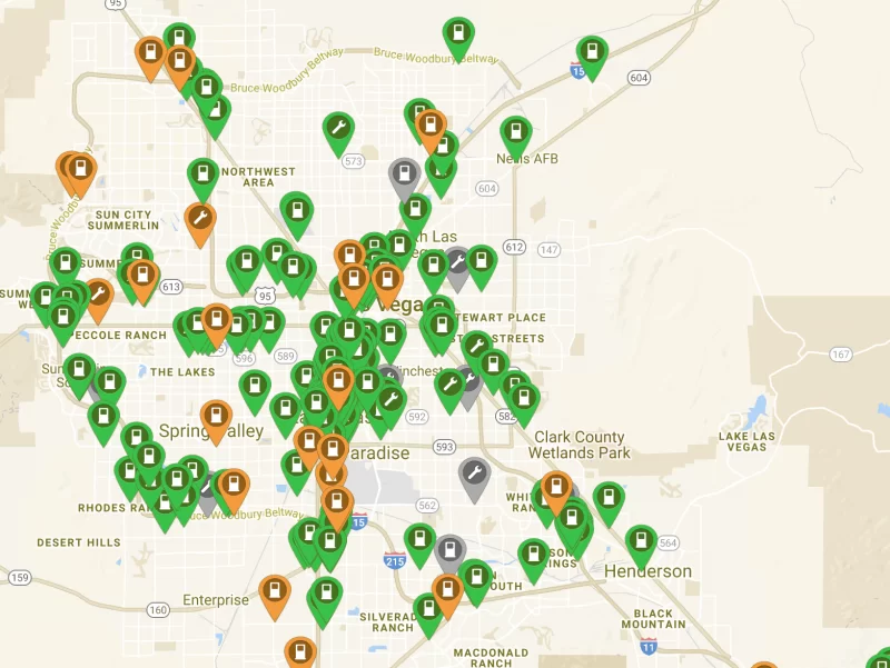

Las Vegas has many stations. One can also use RV parks that have "50 amp" electrical outlets. Shown below (green are slow, overnight chargers while orange are fast chargers of all types) or on plugshare.com
