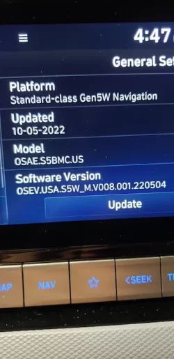

I have a 2021 Kona Ultimate. I have had this 2021 for about 18 months. I am a Senior who likes to look at a Bright Screen which I had until about 2 Weeks ago when all of a sudden it started Giving me a Black Map Background plus other screens also reversed from White to Black. I noticed this usually happened every afternoon between 4 and 5 pm even in Bright Daylight. And on those Bright Sunny Days when I pull into my Garage the screen turns Black again. I originally thought it had something to do with the Time of Day. But now I am thinking it is being caused by an Electric Eye or Photo Cell or whatever they call them, which causes the color to change when I go into a darkened garage. I called Hyundai Customer service and they told me it was a common problem and I need to Reset the Screen by putting a Paper Clip or a small pointed tool in the hole by the right side Radio knob. I used a paper clip but a toothpick also works just fine. I did this numerous times and it did not fix the problem. So I call Hyundai back and get a different person who tells me that the car needs to be parked and a lot of other things. I asked her to email the instructions to me but she never did. I watched a YouTube video where the Reviewer said "If you want to reset your Screen Push a Paperclip into this hole (pointing it out)" then said OK, now let's look at the AC or the Heater or the Tires or Whatever. I researched this Forum for Display and Display Color and Found nothing. Does anyone have any ideas on how to Fix this and get my Bright White Screen Back or who can post all the Correct Steps to follow for resetting the Screen using the Hole by the Radio Knob or other settings? Would Greatly Appreciate it. My Sofware Version is attached if I did this right. But I don't think that is the Problem because it was Updated on October 5th, 2022 and the Display just started reversing colors around December 10th.
If you have your head lights set to auto, the screen goes black whenever the head lights automatically switch on. This can happen during the day under low light conditions, i.e. if its overcast or you pull into the garage, etc.

Finally got a chance to test your theory. I turned off Auto Headlights. Been off for 3 Days. Made no Difference. Still Have a Black Background Screen on Every Screen except the Map and Radio. Maybe that was the way it worked before and I just don't remember it. That is a possibility, but I don't think so because I noticed the screen changing when I pulled into my Garage. That NEVER happened until I said it happened in my first post on this subject. FishOn do you live in the USA or Canada or Europe? Those Cars are Different in many ways. For Example, my Manual says that my Car has Walk-away Door Locks. You get about 6 feet away and the Doors lock. I like that feature a lot because I had it before. So I call Hyundai HQ Customer Service and they Say, Yes, Your Car Does Have Walk-away Door Locks and they say look on Page XXX and I go to Page XXX and they are on the same page XXX. But No Walk-Away Door Locks. They say Let us Research it and we will get back to you. Three Days later they call and tell me it was only available on the European Model. I say then Why is it in My Book without a Disclaimer saying "Only on Euro Models"? They say the USA Book is Wrong.

I live in Canada and my car is the same, ie only the map and radio change to white at times and all the other screens always have a black background.

As for the screens going dark...yes ours does the same thing everytime going under an overpass or pulling into the garage...you get used to it!
