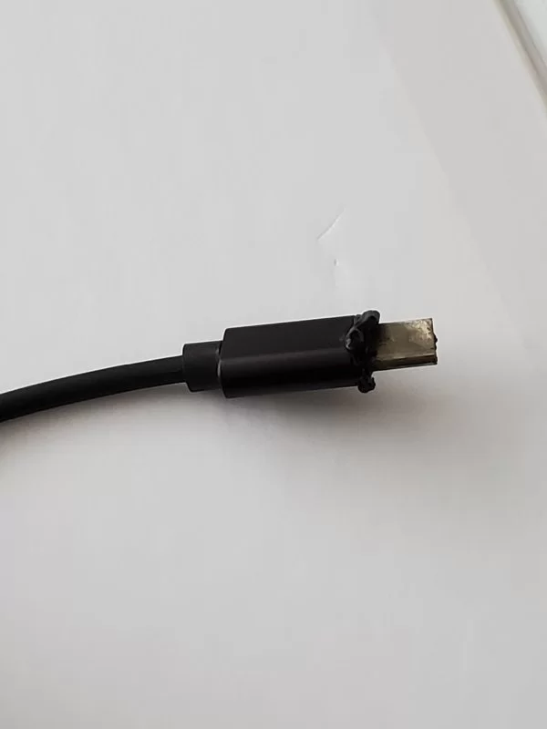

So the anti climactic news is that it wasn't the car but a phone charger that was plugged in the 12v socket that caught fire...
Makes sense and would explain why it would stop when the car was turned off. Was the charger a cheap knockoff from China?
There's no smell in the car now.
I did plug the charger back in and as soon as I did the tip started to get hot and smell.
It's something I got for free with my phone, iQ brand so probably cheap Chinese.
It's the usbC plug that melted, the test of the charger still works.
