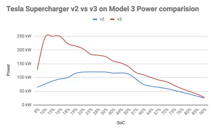

The model 3 & Y will charge at up to 250 kW. Before the taper starts it can achieve 1000 miles per hour of charging.
I realistic terms, you will need to charge for about 10-15 minutes for every 3 hours you drive.
I think that's going to prove to be much too optimistic in real-world use. I'm a strong fan of Tesla, but sometimes the level of hype coming from the company is downright embarrassing. The claim for "1000 miles per hour" of added range when charging is certainly an example.
If you look at the graph of the rate of charging, the Model 3 tapers off pretty quickly. That 250 kW charging rate, supposedly "1000 miles per hour" of charging, probably lasts for only 3-4 minutes, and only if the battery is nearly empty at the start.
(source)
If you think you're going to charge from 10-80% or even 20-80% in 10 minutes, you're almost certainly going to be quite disappointed. My guess is that even a 15 minute charge from 20-80% will happen only under optimal conditions.
(source)
To be fair, I think Tesla was talking about the future potential of the V3 Supercharger - not its use in the current Model 3, which is NOT optimised to make use of it. The chart here is of the M3.
That said, you are right about the hyperbole - nobody knows if any future BEV is going to be able to charge at 1000 miles/hour for a full hour of charging on ANY Supercharger, whether that is V3 or V4 or V26.
