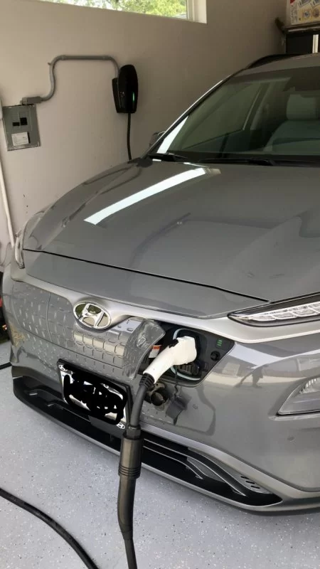

Update: After more tries the Lectron adapter worked less than 50% of the time. After contacting Lectron it is clear that they know there's a problem with their adapter. So I can't recommend it. But they say their new 48A adapter will work every time.

I wonder if they'd swap out your adapter for you? I have the 40A version I bought in November of 2019 and have never had it not work for me, first with my Hyundai Kona and now my RAV4 Prime, have had 100% success rate. In fact I used it in two different places just in the past 3 days. Sounds like you have one that is a lemon, unless the charging stations are the problem.
Good idea on an exchange. But can Lectron really blame the charging stations? Lectron certainly implies that their adapter will work on all tesla destination chargers.
I guess I was thinking you said they seem to know there is a problem with some of their adapters, if that is the case then I would think they would do an exchange if you ended up with a lemon. If the problem is the charging station then I agree, they're going to be less sympathetic in that case.
FYI - I now have Lectron's newest Tesla to J1772 adapter and it works much better! Worked well over 80% of the time. The one charger it didn't work with had a brushed chrome finish, if that means anything. In spite of the one failure I would still call it a win because it allowed me to charge at more hotels on my trip. Starting a road-trip day with a full charge at $0 is a meaningful advantage. I noticed a lot of hotels have one J1772 plug in high demand and several tesla plugs that hardly get used. So having this adapter avoided me having to queue up for the J1772, and freed up the J1772 for others.
I also picked one up (if you are talking about this one 48A max model). I have yet to try it out, but happy to hear it does work well.
