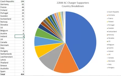

Thanks to everyone for your support so far. My target is to reach 1k supporters before I go back to Tesla. I'm almost half way there. I will appreciate your further support if I have not yet reached the pinnacle of your interest. If anybody is interested in breakdown per country, data attached. Still struggle to get international support especially in EU where I think this feature is relevant due to ubiquitous 3-phase electrical grid.

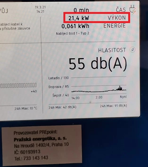

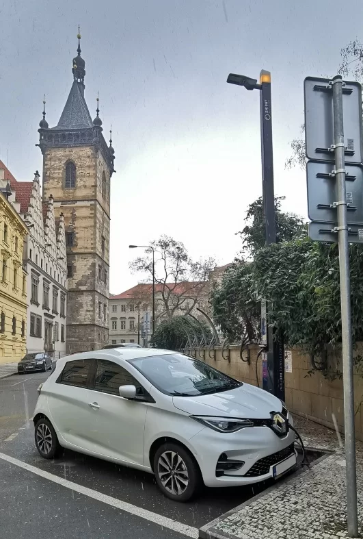

In Europe we have 3-phase electrical grid. 22kW means 230x32x3 = 22,080 kW. In EU, 95% of public AC chargers are capable of delivering 22kW. You can check my Zoe charging in downtown Prague at 21,4kW to be exact :)
