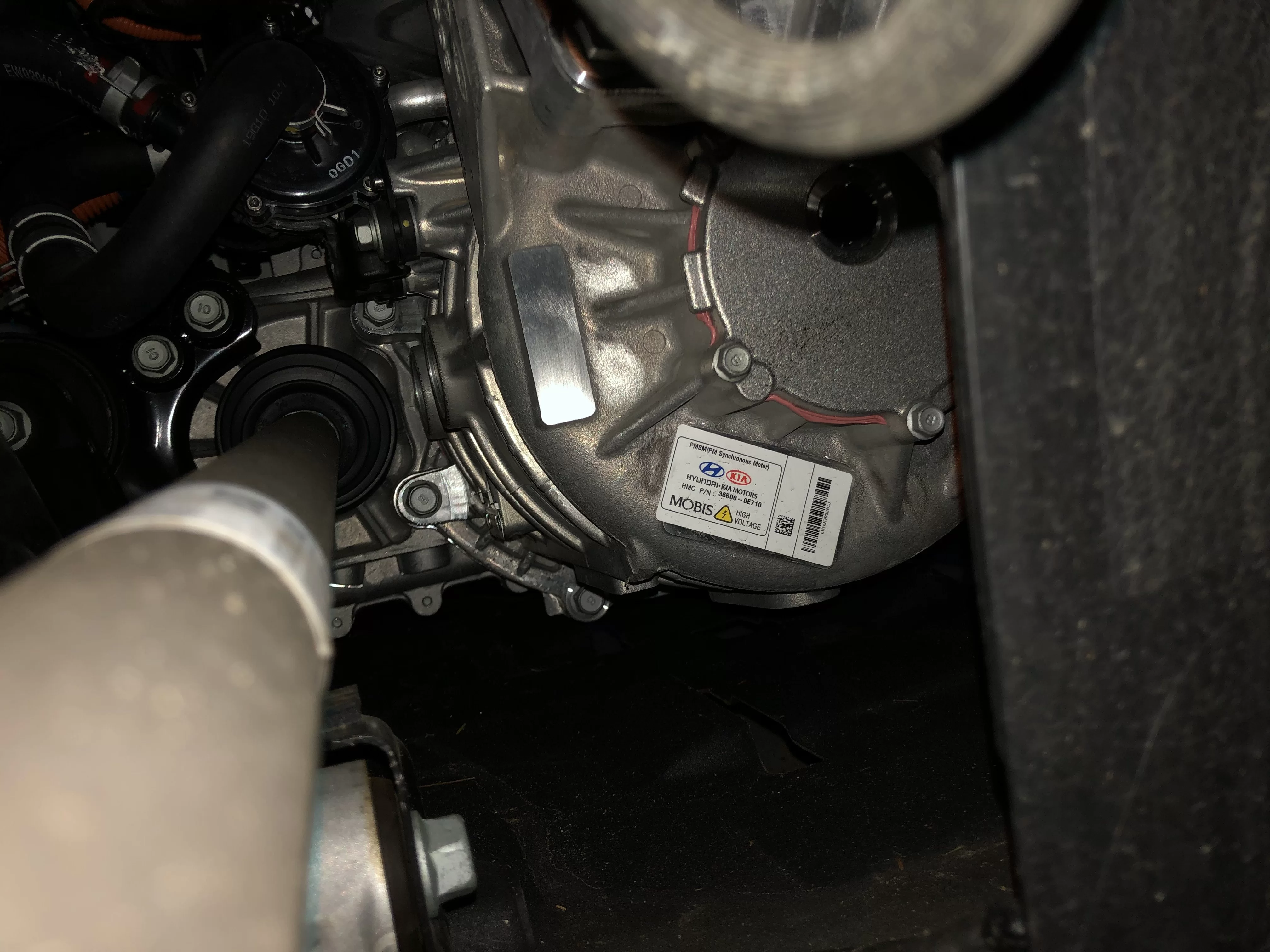

I knew the electric Kias had been around for a couple of years globally with little modification to the power systems except increasing the battery pack size from what they had for the Soul initially. I had hoped the gotchas would have been found. Well, I have the 710 motor. At almost 1000 miles...we will see.
Is it known what is going wrong? Broken gear tooth? Something else?
KIA is unlikely to publicly admit anything is wrong or offer any explanation in fear of class action litigation.
From that angle, your 710 motor revision looks identical to my 711. Other owners who have done the repair also have not found any externally visible differences. Supposedly the mechanics have said that some of the bolts and their supports have been lengthened and reinforced connecting the transmission. Maybe the whole thing is just coming apart at the seams from the high torques? Baffling how the design made it to production without someone noticing a problem.
I'm fairly confident in the parts shared with the regular Hybrid Niro (now on third year) but I do wonder how well they tested the new EV-specific components of the car. In addition to the motor issues, we also have an official water pump recall that affected early cars like mine.
