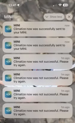

This is an annoying new bug.
I requested it once. My phone pinged six times in quick succession.
