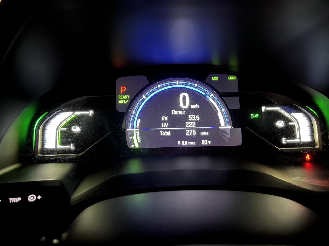

This morning:
Regardless of how I’m driving, this appears to be going the wrong way…
