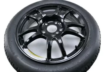

I do like the idea of carrying a spare, and would likely procure one if a substantial road trip were to come up.
While on this topic, in trying to interpret all the great facts in the detailed thread mentioned in Post #2...
Is it fair to conclude that a 'best' choice would be?:
  • The Infinity G35 T145-80D17, along with
  • A 66.1 mm to 64.1 mm hub centric adapter, and
  • The appropriate lug nuts (either Acorn or Mag type, depending on the wheel).
I would like to ask this... It seems that there are 3 different types of wheels that fit this description:
1. Spoked style (they are aluminum):
2, 3. Solid style (Available in either Aluminum or Steel):
Is it safe to say that any of these three would work fine?
I am assuming that the spoked wheel would tend to be the most expensive,
followed by the aluminum version of the solid wheel, and steel would be the cheapest?
So, cost vs. weight... Any idea how much lighter the aluminum versions are vs. steel?
Is spoked aluminum lighter than solid aluminum?
Probably don't really care about aesthetics since they are all very temporary.

I've got the Infiniti GT35 17" spoked wheel with a T165-70-17 tire that weighs 30 lbs. A friend of mine has the steel Nissan Maxima 17" wheel and it is definitely heaver. I found a 17" steel wheel with 165-70-17 on google that said it was 36.5 lbs. So I'm guessing like 6 pounds difference between steel and spoked aluminum. I'm also guessing there isn't much difference in weight between the spoked aluminum and solid aluminum.
I changed out my 145/80/17 to the 165/70/17 on the Infiniti G35 spoked wheel. Here's a post that shows the difference in the tires.
https://www.insideevsforum.com/comm...ire-for-compact-spare-tire.10704/#post-128278
I also have the G35 spoked-wheel spare (with hub adapter and lug nuts) and the necessary tools. Last month I bought a new tire for the spare (original was 13 years old), and then took the Clarity on a 3-week, 6000 mile trip (CA to NY to MD and back). I prefer to be self-reliant so I had a basic tool kit with me too. (On a prior trip in 2016, my Suburban broke down in WY in a cell phone dead-zone.) BTW, the Clarity is the most comfortable car I've ever used for a cross-country road trip (which I've done about 10 times in 7 different vehicles). It averaged 40 mpg doing 75-85 mph most of the time. I stayed in campgrounds, and had no problem carry my gear, including a big 1970s Coleman convertible ice chest in the trunk. My only worry was that the AC would break down during the trip, but it's still blowing cold (and I did install the evaporator guard prior to the trip).
I haven't looked into a hub adapter, what adapter do you have? I also wasn't aware the lug nut need to be changed? This forum is such a help.
