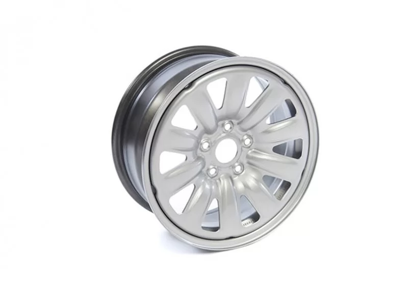

Has anyone tried the Premium Steels Wheels from Hyundai advertised in the Build a Kona EV app on their website? $672.92 - I presume for a set of four.
I’m not sure if they were the same wheels. Our dealer provided winter tires and steel rims. The rims didn’t fit and they had to change ours to the alloy rims. Quite possible the rims they tried were not the premium steel rims listed on the Hyundai website, but maybe they were.

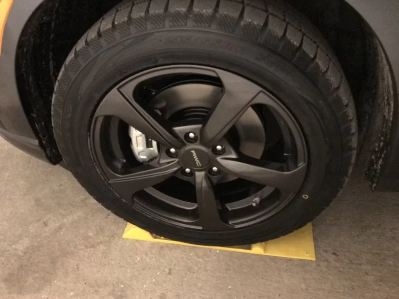

Those are winter wheels - nice. Snow tire brand if so?I have aftermarket for the all season khumo ecsta UHP . Pirelli winter on OEM wheels. No more chirping on acceleration with either setup.

I posted aftermarket: ITM UNI-Sensors are about $60/each. No reprogramming when I reinstalled the aftermarket summer wheels post taking the Nexens off. Just drove,and the summer/winter setups have now synced.
