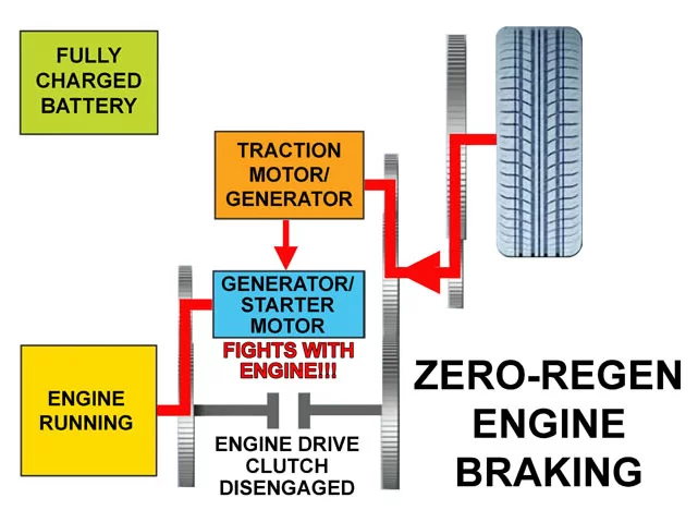

I really hope Honda's engineers someday publish a paper to explain this phenomenon. The Insight and Accord Hybrid don't do that. When they need to dispense with regen electricity that cannot go to a fully charged battery, the power coming from the traction motor operating as a generator goes to the starter motor/generator operating as a motor to turn the deadened ICE. So why would the Clairity PHEV not do the same thing? My theory is that the heavier Clarity PHEV needs to dispense with more energy on a long decline than those other hybrids and the only way to do that is to have the starter motor/generator trying to slow down the running ICE. Certainly the ICE doesn't start up and drive the starter motor/generator to generate MORE electricity, so having the starter motor/generator fighting the ICE seems to be the only way to explain how the Clarity PHEV deals with the excess electricity. Just my theory, with nothing to back it up. I made up this diagram to illustrate my theory:

I assumed the starter motor was turning the dead ICE on the Clarity, also. But the ICE runs after excess regen use is complete, to lubricate and warm up the ICE.
From your comments, sounds like the ICE's on Insight and Accord don't run after excess regen use: But this could be the only difference between the two systems (Insight/Accord vs. Clarity)
