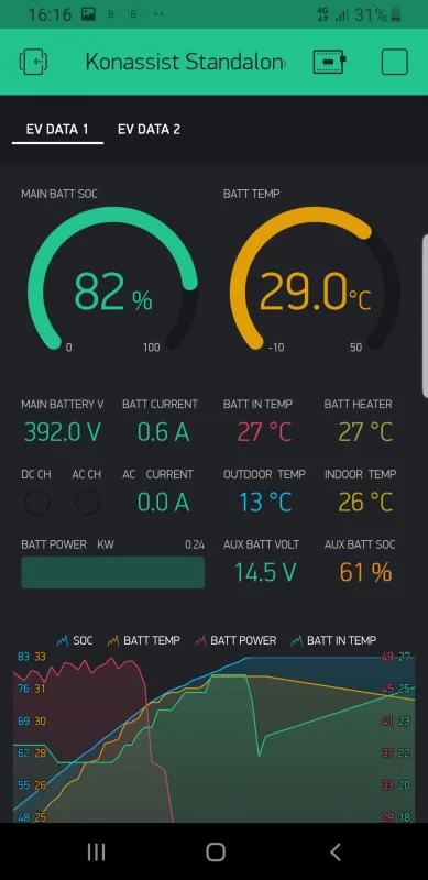

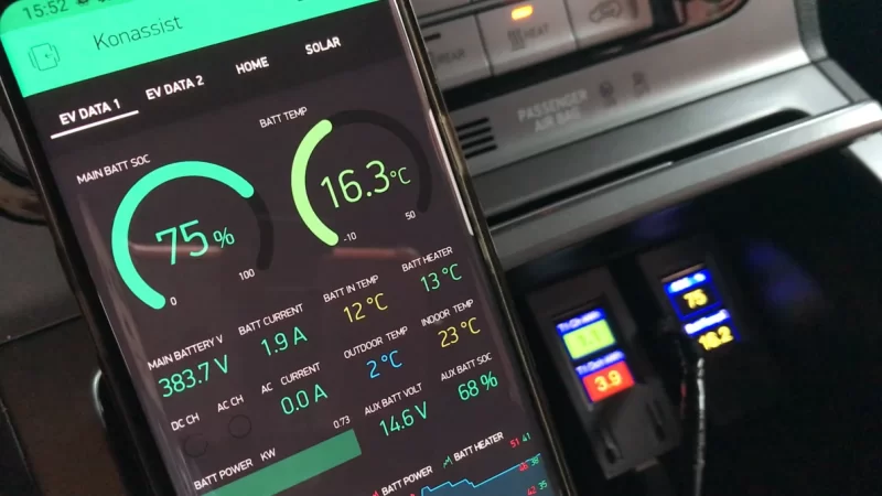

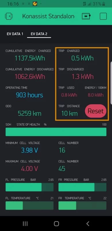

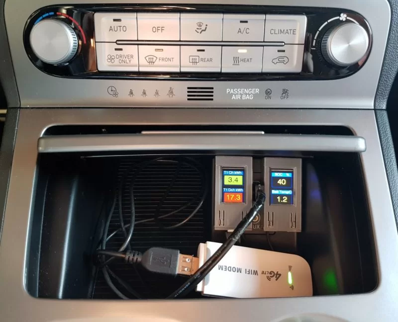

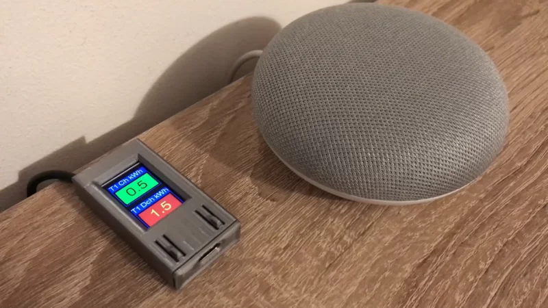

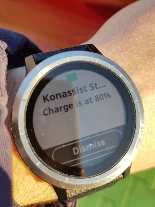

For DIYers, I just want to share my Konassist Opensource version, using Arduino & ESP32 + OBD Bluetooth adapter + Blynk app with Konassist project + optional Google Assistant or Home device.
I built 2 versions: Standalone (without GAssistant) or Full with Google Assistant/Home device support (can answer in different languages), both supports notifications.
Some pictures:

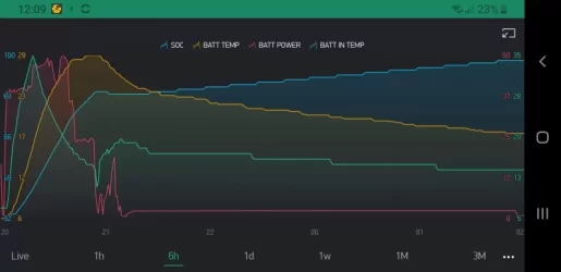

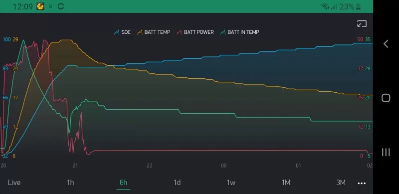

Charging graph: DC 50kW then AC at home with 2.7kW Screenshot_20201215-120933_Blynk.webp
Konassist_Blynk_r.webp Konassist_Home_r.webp 4G_USB_Wifi_Modem.webp Konassist_Standalone_Avg_kwh.webp Konassist_Standalone_Batt_Temp.webp Notification_80.webp
