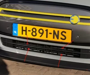

The point of the active grille shutters is to reduce the open area in the front face of the car. The ideal aerodynamic shape is a completely closed off front bumper with no openings but openings are required for cooling and AC and the front bumper is the best spot (high pressure zone). The air that flows into these openings and through the radiator has to go somewhere and is typically dumped out into the wheel wells and under the car, disrupting the existing smooth airflow. By closing off the lower opening when more cooling airflow is not necessary, aerodynamics can be improved by reducing the disruption. When more cooling is required, they can be opened to increase airflow.
Wow - okay - I had no trouble mounting my GoPro on the bumper and getting footage of the active grill shutters. And thank goodness I did. I looked at my footage - the shutters close as soon as the car is started, and open when the switch is turned off. But, as I got up toward 60 mph, I could see the entire shutter assembly being pushed backward toward the radiator by the air. When I got home, I pushed on the right hand part of the assembly - it was solid. I pushed on the left hand side, and it is completely detached from the bumper assembly. I believe I have found my first warranty repair. EDIT: Now that I thought about it some more - this was probably damage from something striking the car, possibly. I bet I’ll have to pay for it.
I’ll post the video in a bit. I think the weather was not warm enough (71F) for the shutters to open while driving, so I was not able to verify that.
