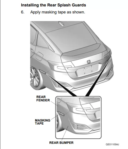

Hi, I have a curious question regarding installing the Rear Splash Guards.
What is a purpose of masking tape (step 6)?

No freaking clue.... I did it and had to cut through the middle to be able to unclip the side of the bumper.
IMHO it was completely useless and waste of time to cut the fabric and the plastic - the screw would have made it through anyway. I doubt if you get a dealer to do it, they would go through this hassle.
Save yourself 1 hour of your life and have a beer instead.
