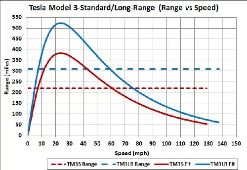

Re real-world range:
I can't speak from personal experience, but there are a lot of comments posted to the Tesla Motors Club forum -- it may be an overstatement to call it a "consensus", as that never seems to exist in forum discussions, but a lot of them -- which claim that you should get approximately the EPA rated range when driving a Tesla Model 3 in optimal conditions -- in fair weather, no use of cabin heating or cooling, flat ground -- at highway speed between 60-65 MPH. Of course, at higher speeds you'll lose some range. That's just basic physics, and unavoidable.
Do be warned that in below freezing weather, the Model 3 takes a pretty severe hit to range, perhaps more so than most BEVs. The Model Y has a heat pump, which the TM3 doesn't; the TMY should do better with that situation.
TtGelMfQNCvHlCz3XEYRr00F35_RdHh5wLKpUO_ntuWPYkpqx21wKcuWDPac_aZA0lEXziyov0djPVGPSvf5AvZ1qXoM8tujrlmAyf6bPNn_7raXlQ
Source for the graph above: http://www.roperld.com/science/TeslaModel3.htm
I don't know how old that graph is, but my guess is that it's for an older version of the Model 3 (probably 2018 or earlier), and that it doesn't include recent updates to the car which have slightly improved the range.
