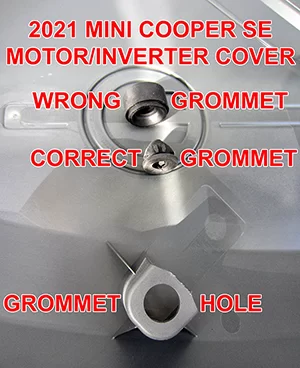

I just returned from the body shop. The grommets (they came as a packet of 4) that took more than 6 months to arrive are the wrong grommets! So I cannot give you the correct part number. I'm waiting for a call-back from Motor City MINI, who obtained these grommets from MINI. I will ask them for the correct part number.
To make my needs clear to the dealer, I removed one of the remaining 3 grommets in my cover so I could make the annotated photo below. To my surprise, the grommet was difficult to remove! I tore it in the removal process!! I expected it to almost fall out in my hand--I don't understand what happened to make the missing one disappear so easily when I was showing off what's underneath the cover. So now I need 2 grommets.

My advice would be to twist the grommets every time you remove the cover. They should twist easily if the rubber retention prongs are not crowding the grommet hole as the grommet prepares for its escape.

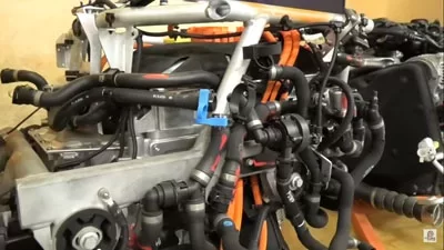

Look what you could see if you could just pop off the wheel and fender (where's the heat pump in this mess of hoses?):
Do you know about the frame that holds the engine and inverter? MINI designed it to attach to the same mounting points as the engines in the ICE MINIs. It also helps protect the components inside the frame in an accident. Orange wires! Everyone expects to see orange wires under the hood of an EV but you can't see them when the cover is in place.

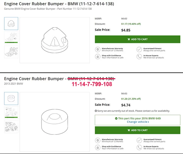

My Motor City MINI parts guy told me he is arguing with MINI's corporate parts department. He tried to order part 11-12-7-614-138, but they told him he was wrong and sent 11-14-7-799-108 instead.
When I googled 11-12-7-614-138, I found images of the grommets we need, but also the grommets I received with the same part number!
I'm happy to learn these grommets are also used for BMW engine covers instead of being a custom part made for only the MINI Cooper SE because that increases the chances we'll get what we need and at a reasonable price.
