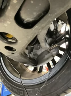

So it happened again last Saturday last week, the metal grinding noise came back. I scheduled the car to be check last Monday and yup the metal grinding noise was there when I left and when I arrived at the dealer.
They hoisted the car and did a proper disanosis, they even attached mics to the back of the wheel to determine where the noise was coming from, see attached pic.
They determined that the metal plate between the toe arm and disc brake got misaligned, they fixed it and the metal grinding noise is now gone.IMG_0691.webp
