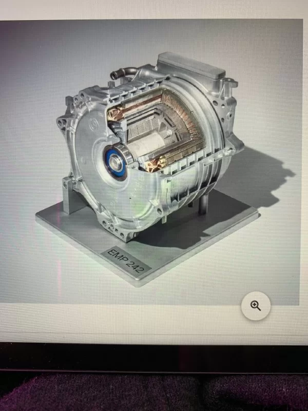

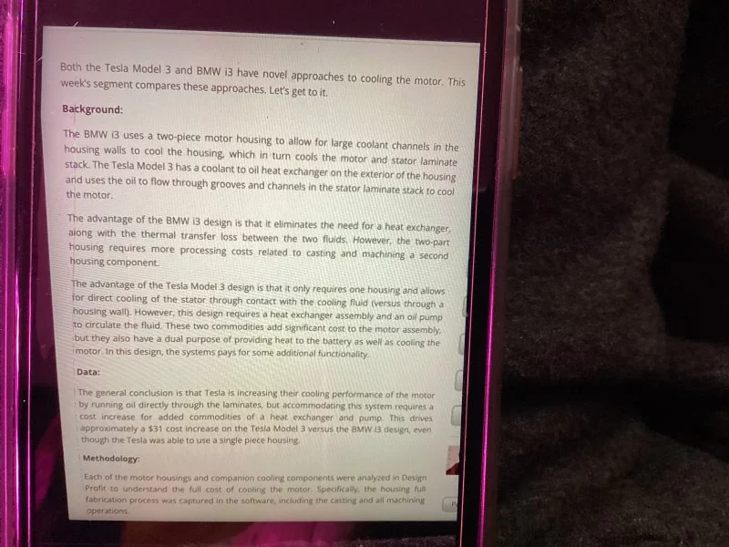

That BMW I 3 /S motor is liquid cooled the exterior of the motor Is
build with double walls and liquid circulate between to take a heat away.
I couldn't find a chiller or compressor for the engine cooling loop. I remember BMWs needed extra air for the radiator when on dyno machines.

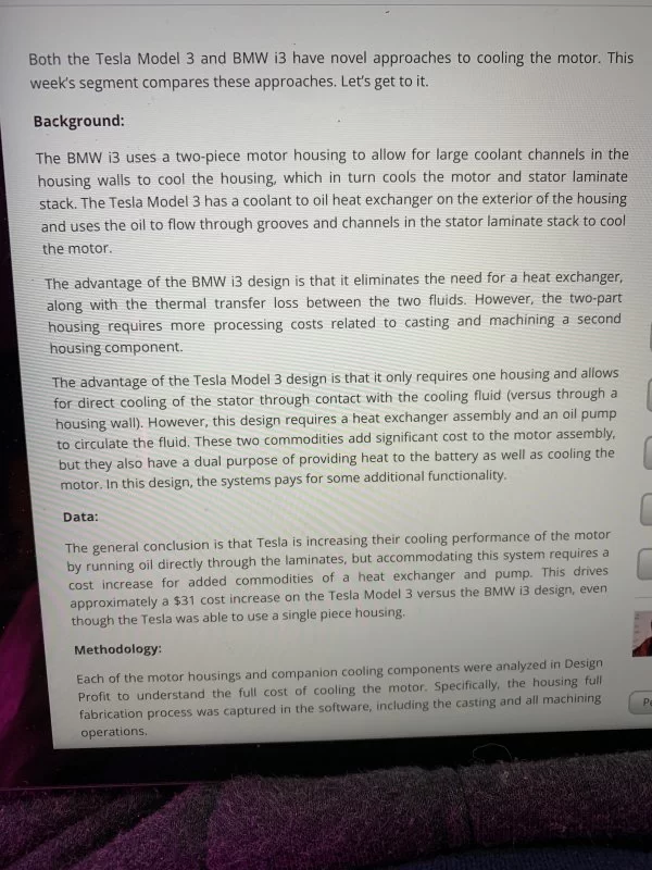

Hi Teslarati 97 read this give you some idea how BMW I 3 motor is cooled and Tesla also ,great reading .
I believe the rotor is the hardest part of the motor to cool and rotor temp could be what is limiting power. If the magnets get too hot, there's a risk of demagnetization and permanent damage and they are not liquid cooled (only the stator/windings are)
According to Car&Driver magazine the Havac system in Mini SE is very complicated system .English is not may first language,never take any classes but I try to explain how fluid is cooled in motor .Basically the same way like ICE car .Make simple liquid run through a motor electric which is build with double walls/shield and pump push a liquid through radiator to cool.Sensors controls temperature .Ev motor works the best at temperature 60-104”F.the same is with high voltage batteries.Any thing above or below Ev is loosing performance,power- speed and range.overheating batteries results in car shots all systems.Cold is a bit friendlier.Heat exchange pump take care of your heating and cooling which run on gas which is compress etc.To much to explain.Heat pump is very efficient but problem start when is cold say below 32” F and a unit can’t collect ambient heat from outside but try to get heat from under the hood whatever motor etc .but your car not going to be toasty like ICE car.That’s why you use heated sits and steering wheel heated and you dress like going to ski in 10 degrees weather .AC works good bc heat pump do a job .Also you precondition a car interior not big batteries they get worm when you start driving only in cold weather when the weather is hot the heat pump do a job to try cool them through 100 feet of hoses and dozens of sensors .Conclusion is a Mini Se is the best car when temperatures are mild 50-90”F .Owning garage with 60 “ temperature I rarely use any of those systems with my limited mileage driving .And not abuse Mini ! Obviously all those informations are there but this is explanation for 5 grader’s.
