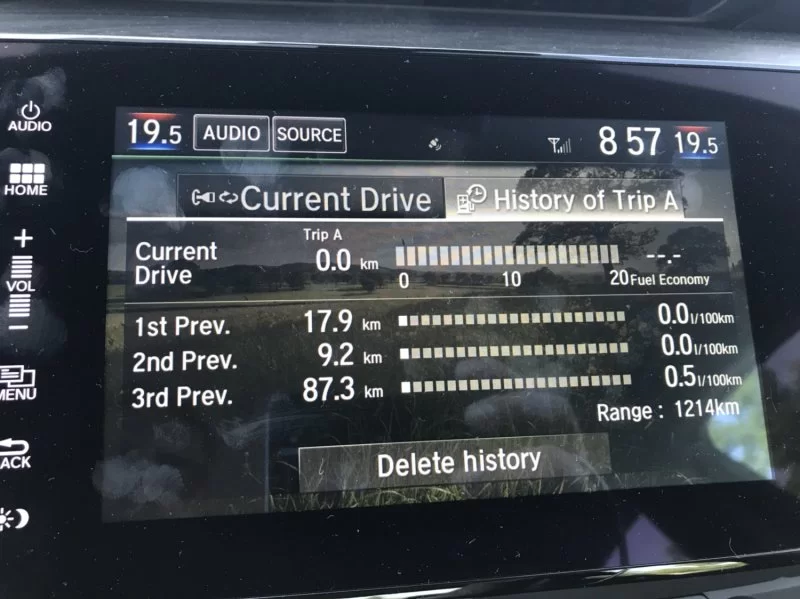

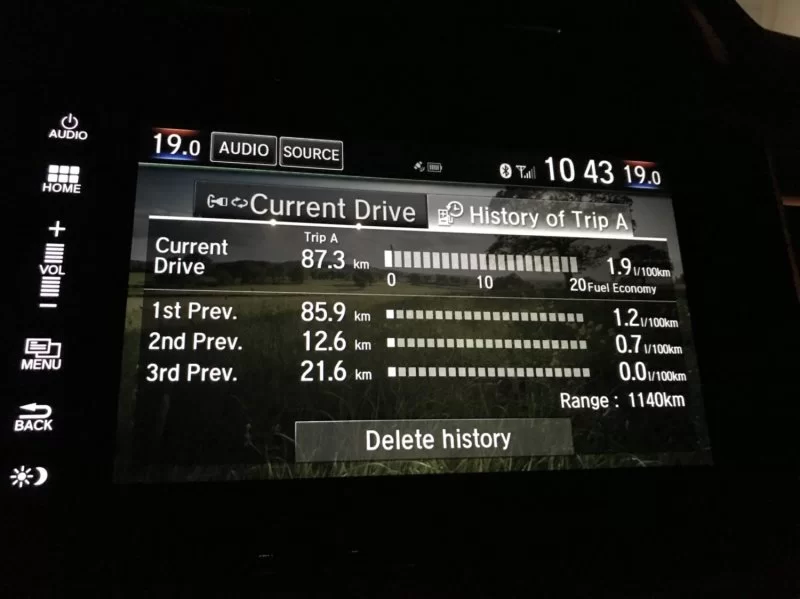

2. I am trying to monitor fuel consumption per drive. Just for fun [emoji846]. So I snap a photo of fuel consumption every few drives. See two photos attached: the last drive on the first one is the first drive on the second. It is all metric, but it easy to see that somehow the fuel consumption changed. Any ideas?IMG_1660.webpIMG_1654.webp

The situations listed did not exist - the temperatures in Toronto are comfortable these days, the battery was full and no high torque driving.
The regen seems to be the consensus, however I fail to understand how the engine start would help in this situation... Unless instead of regen breaking Clarity uses engine break???
The "System Check" is kind of a general catch all that we don't really know what that means. The manual says a system check may be run at any time the car is powered on, so it really is vague.
My hunch is the full battery + regen, there is some speculation of what is going on there, but not so sure if it is a bug or somehow using the engine for engine braking instead of charging the battery.
