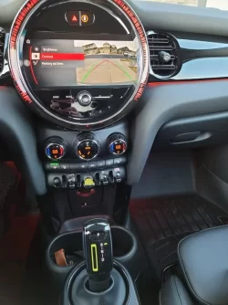

I neither could turn the lines on nor could change the brightness/contrast while in reverse, those options are grayed out on my signature trim. Is that expected?

I just confirmed on mine that I can change the settings with the car in reverse. Just to confirm, you are clicking left on the iDrive knob then scrolling up and down to select the setting and it says "contrast" just greyed out?
That’s right, I’m able to scroll up and down across those three options but pressing iDrive knob to select one of them does nothing.

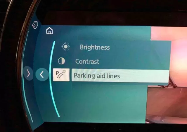

I just took delivery of my Signature trim SE and I have the same issue. I can't select any of the options (Brightness, Contrast, Parking aid lines) for the Rear View Camera. I can see them and select them, just can't do anything
Just want to update this post. I took my SE Sig trim yesterday to the dealer and told them about the Rear-View camera options not being operational. Options for Brightness, Contrast and Parking aid lines are there but doesn't do anything when you select them. I don't even have parking aid lines showing on my rearview camera so it's just like I bought a 3rd party camera. Sucks. Here is what the dealer said this morning: "We tried to program your car. Buttons for rear camera still inoperable. Mini engineering was contacted. They are having a issue with this and this is under investigation. They are currently trying to work on a remedy..."

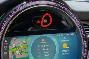

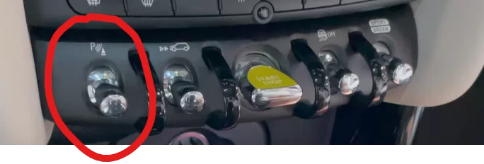

Doesn't this switch actively turn them on/off?
There was a similar button in my i3 that I would press to turn the parking sensors off when I didn't need them (like drive-thru windows/etc).

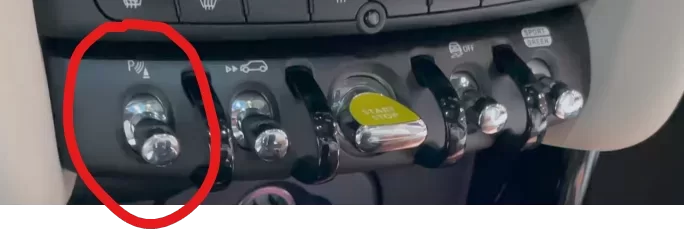

That's the parking assistant switch. I don't think it was an option for the 2022 Signature Trim. It's listed as standard features for the 2022 Iconic Trim.
Gotcha - It looks just like the button I'd use in my i3 to turn it off when necessary.

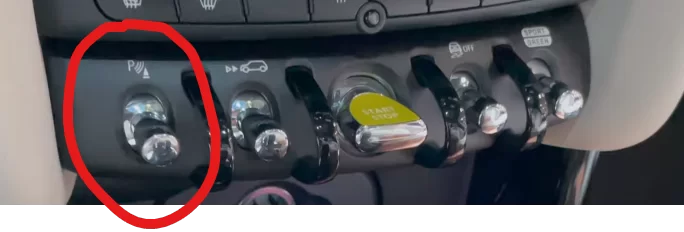

What about this button?
