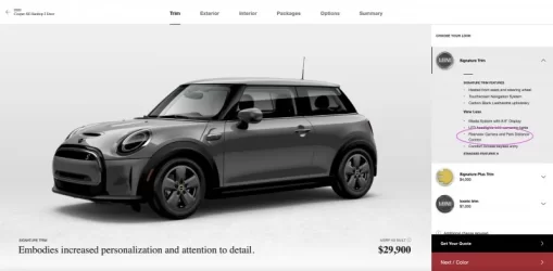

Ii am at the dealership closing my deal. I showed the salesman and GM the first page of the build your own on their website.
My car doesn't have option 507. GM was on phone with zone rep a good 45 minutes. Was offered a few things. Took $500 towards Mini brand accessories. I will get winter mats, and the cargo mat to start.
What else is useful?
If you have a signature on order take a screenshot of the web page now. I think they will be fixing it shortly. Good luck.

Take a picture of the website
They had fixed the site toward the end of the build process that says only camera. The way it is written in the first page infers it is one item, camera with beepers, not camera, and also beepers.

Still there. Salesman showed me the bulletin from BMW USA that said they are deleting it from Signature, but keeping it on plus and iconic because of the chip shortage.
Go to
Build yours - Trim -Signature - standard features
https://www.miniusa.com/build-your-own.html#/studio/elk8a0lf/trim
Signature Trim
SIGNATURE TRIM FEATURES
  • Heated front seats and steering wheel
  • Touchscreen Navigation System
  • Carbon Black Leatherette upholstery
View Less
  • Media System with 8.8" Display
  • LED headlights with cornering lights
  • Rearview Camera and Park Distance Control
  • Comfort Access keyless entry
If you do a complete build, the GM told me at the end it says only rearview camera. The deceptive part is there is no comma in the features. Looks like the camera and distance control are one option code, not two, so when one gets to the end it is assumed they are both part of one package.
Like media system with 8.8" display. The media system is probably one option code, and last year there were two displays, so the 8.8 is/was probably a separate option code.
