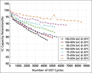

This graph from the Battery University assumes full fast charging. If you fast charged daily for a commute, that would be 250 charges in a year. Most vehicles are owned for six years. That is 1500 cycles. Say you keep the EV for 20 years that is still only 5000 cycles. So basically after 20 years of DC fast charging at the harshest charging 25-100% you'd still have 80% of your battery. Between 25-85%, 84% capacity after twenty years of daily DC fast charging. In short, you will outlive your battery in most cases. I only DC fast charge on trips, otherwise I level 1 charge when not driving. That easily keeps the battery between 50-80% or the purple line. I expect that after twenty years, I will still have 90% range left as I DC fast charge ~5x's a year. In summary, Northern Lights hit the nail on the head with his Battery University link. If I were commuting, I would charge as needed for the commute and not worry about levels. If you can commute daily with 80% or less, more power to ya.
Not to be fastidious, but the way I read it, @ 25 to 100%, 80% retention went away at just over 3500 cycles.:oops:
But even at ~ 14 years, not really too much to complain about
