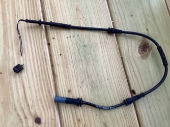

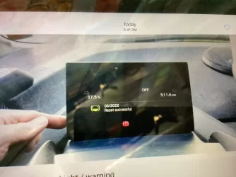

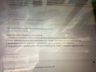

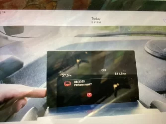

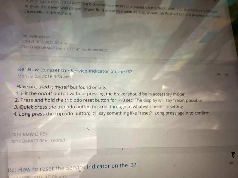

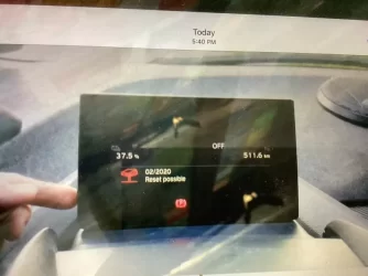

I recently changed out the brake pads to ceramic hoping to reduce brake dust. In the process I damaged the brake sensor in the rear. So now I get service required in 900 miles for brake pads. I thought I would be smart and purchased the BMW/Mini software for my FoxWell scanner. I could not find the service reset. So I turned to this forum and sure enough someone figured it out. They got the info from the BMW i3 forum. So I suspect these cars share a lot of electronics? Anyway I went out and sure enough it worked. My car is a 2023 Cooper SE. THANKS go to REXSIO a long time member.
The instructions:
How to reset the Service Indicator on the i3?
  1. Hit the on/off button without pressing the brake (should be in accessory mode)
  2. Press and hold the trip odo reset button for ~10 sec. The display will say "reset possible". The button is on the upper left hand side of the center display.
  3. Quick press the trip odo button to scroll through to whatever needs resetting
  4. Long press the trip odo button; it'll say something like "reset?" Long press again to confirm
