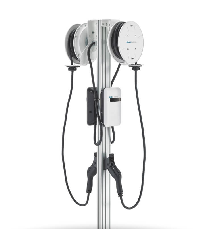

Evocharge has Electric vehicle load management capability, and would suit well for this purpose:
Additionally, billing can be handled using RFID readers (EvoCharge iEVSE Plus):
