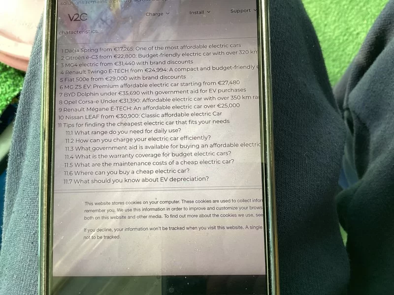

look at a price of electric cars in EU I put a picture prices in EU I’m in USA Mini SE $20000- $ 22000 price as a year 2022-2024 is not reasonable to shipping to pay extra $ and your SE to EU as 114 miles range as you get similar car Dacia/ Citroen and more models with similar price brand new good service living in France and my happens your Canada model my not meet EU requirements just sell it in Canada as they get more rare for good price and get new there is a way to go as I was living in EU 30 years and in USA 44 years Old dud with very conservative approach as my kids 48 and 50 years old never taking my advice at all .And Mini Cooper SE J01Chinese build I believe is available in EU with 250 miles .as you want to fit in Mini Cooper bc you love a car .Better speak French there for your advance not English .
look at a price of electric cars in EU I put a picture prices in EU I’m in USA Mini SE $20000- $ 22000 price as a year 2022-2024 is not reasonable to shipping to pay extra $ and your SE to EU as 114 miles range as you get similar car Dacia/ Citroen and more models with similar price brand new good service living in France and my happens your Canada model my not meet EU requirements just sell it in Canada as they get more rare for good price and get new there is a way to go as I was living in EU 30 years and in USA 44 years Old dud with very conservative approach as my kids 48 and 50 years old never taking my advice at all .And Mini Cooper SE J01Chinese build I believe is available in EU with 250 miles .as you want to fit in Mini Cooper bc you love a car .Better speak French there for your advance not English .View attachment 24001
